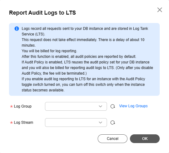

- Logs record all requests sent to your DB instance and are stored in LTS.
- This request does not take effect immediately. There is a delay of about 10 minutes.
- After this function is enabled, all audit policies are reported by default.
- Audit logs are generated every hour. If the size of an audit log exceeds 10 MB, a new audit log is generated.
- If Audit Policy is enabled, LTS reuses the audit policy set for your DB instance and you will also be billed for reporting audit logs to LTS. (Only after you disable Audit Policy, the fee will be terminated.)
- If you enable audit log reporting to LTS for an instance with the Audit Policy toggle switch turned on, you can turn off this switch only when the instance status becomes available.

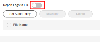

- In the navigation pane on the left, choose Audit Logs.
- On the Audit Logs page, click
next to Report Logs to LTS.
Figure 1 Enabling Report Logs to LTS

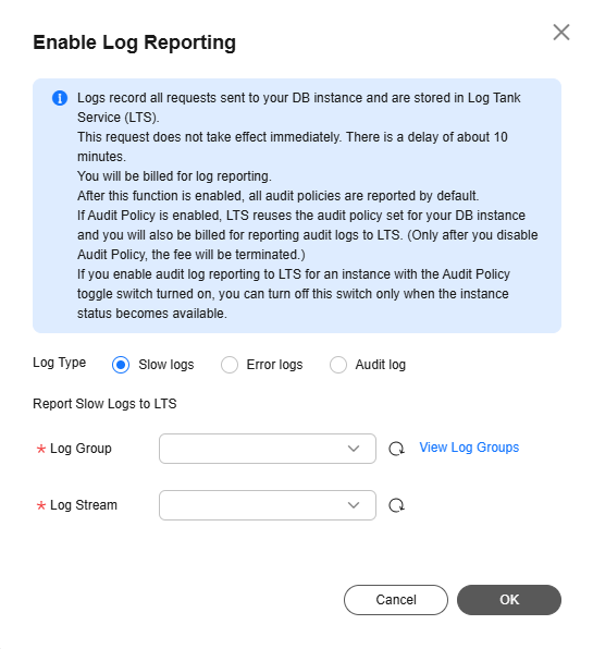

- In the displayed dialog box, specify Log Group and Log Stream.
Figure 2 Enabling audit log reporting to LTS
- Click OK.

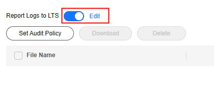

- On the Audit Logs page, click Edit next to the Report Logs to LTS toggle switch.
The editing function is available only when the Report Logs to LTS toggle switch is turned on.

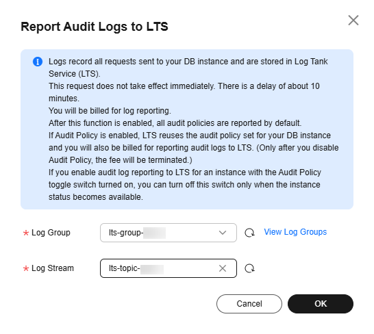

Select the target log group and log stream.
Figure 3 Editing audit log reporting to LTS
- Click OK.

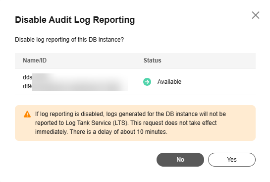

Figure 4 Disabling Report Logs to LTS
- In the displayed dialog box, click Yes.
Figure 5 Disabling audit log reporting to LTS

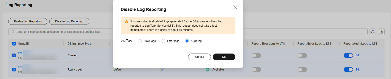

- Select target DB instances and click Disable Log Reporting.
Figure 7 Disabling log reporting to LTS in batches
- In the displayed dialog box, click OK.
