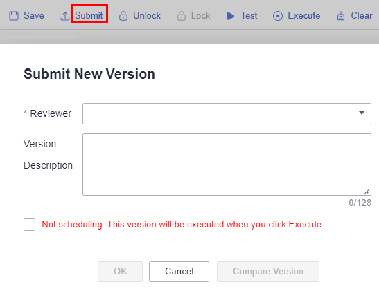

  4. Above the job canvas, click Submit to submit a version. In the displayed dialog box, enter the change description (a maximum of 128 characters allowed) and select the check box below. If you do not select this option, you cannot click OK.
    Figure 2 Submitting a version

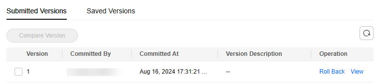

After submitting the version, you can view it in the version list. (Currently, a maximum of 10 latest versions are saved.) Click Roll Back to roll back to any submitted version.

  4. On the right of the page, click the Versions tab and view the version submission records. Select the version to be rolled back and click Roll Back.

  4. On the right of the page, click the Versions tab and view the version submission records. Select the desired version and click View to view its details.
    A new page is displayed, showing the job definition of the version. You cannot modify any job attributes in this window.
