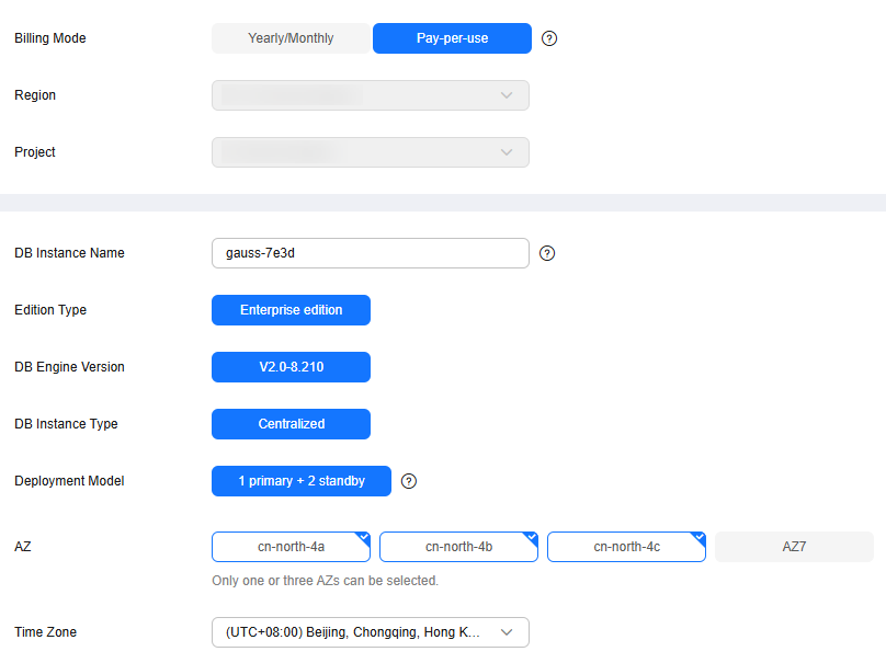

- On the Rebuild DB Instance page, select the billing mode, enter the instance name, and specify other parameters such as the AZs and time zone.
Figure 2 Billing mode and basic information
Table 1 Parameter description Parameter
Example Value
Description
Billing Mode
Pay-per-use
GaussDB provides yearly/monthly billing and pay-per-use billing.
- Yearly/Monthly: You pay upfront for the amount of time you expect to use the DB instance for. You will need to make sure you have a top-up account with a sufficient balance or have a valid payment method configured first.
- Pay-per-use: You can start using the DB instance first and then pay as you go. Pricing is listed on a per-hour basis, but bills are calculated based on the actual usage duration.
DB Instance Name
gauss-7e3d
The instance name is case-sensitive, must start with a letter, and can contain 4 to 64 characters. Only letters, digits, hyphens (-), and underscores (_) are allowed.
Failover Priority
Reliability
This parameter is only available for distributed instances using independent deployment.
- Reliability: Data consistency is prioritized during a failover. This is recommended for applications with highest priority for data consistency.
- Availability: Database availability is prioritized during a failover. This is recommended for applications that require their databases to provide uninterrupted online services.
AZ
AZ1
An AZ is a physical region where resources have independent power supply and networks. AZs are physically isolated but interconnected through an internal network.
Time Zone
(UTC+08:00) Beijing, Chongqing, Hong Kong, Urumqi
You need to select a time zone for your instance based on the region it is hosted in.

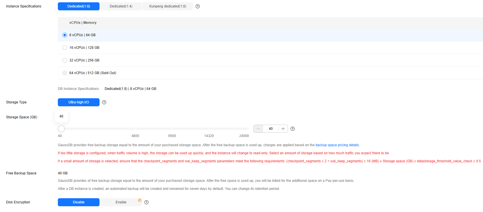

- Configure instance specifications.
Figure 3 Specifications and storage
Table 2 Parameter description Parameter
Example Value
Description
Instance Specifications
Dedicated(1:8); 8 vCPUs | 64 GB
The vCPUs and memory of an instance.
Storage Space
40 GB
The storage space contains the file system overhead required for inodes, reserved blocks, and database operations.
Disk Encryption
Disable
Enabling disk encryption improves data security, but slightly affects the read and write performance of the database.

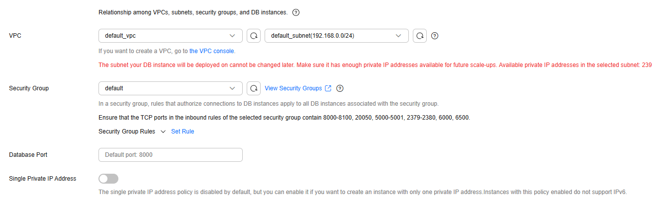

- Retain the default settings for the network configuration.
Figure 4 Network configuration
