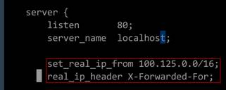

- Add new fields and information to the end of the following configuration information:
Add the following information under http or server:
set_real_ip_from 100.125.0.0/16; real_ip_header X-Forwarded-For;
Figure 2 Adding information
Add the IP address range of the proxy server after RemoteIPInternalProxy.
CIDR block of the subnet where the load balancer resides
- Dedicated load balancers: CIDR block of the subnet where the load balancer resides

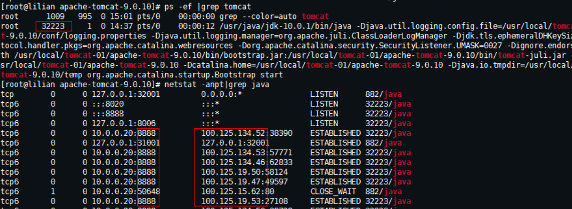

Tomcat Servers
In the following operations, the Tomcat installation path is /usr/tomcat/tomcat8/.
- Log in to a server on which Tomcat is installed.
- Check whether Tomcat is running properly.
ps -ef|grep tomcat netstat -anpt|grep java

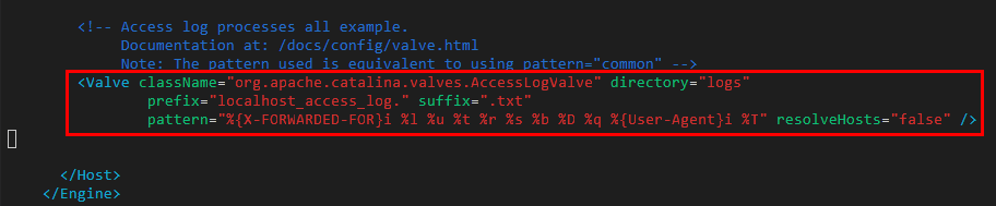

- Modify className="org.apache.catalina.valves.AccessLogValve" in the server.xml file as follows:
vim /usr/tomcat/tomcat8/conf/server.xml
<Valve className="org.apache.catalina.valves.AccessLogValve" directory="logs" prefix="localhost_access_log." suffix=".txt" pattern="%{X-FORWARDED-FOR}i %l %u %t %r %s %b %D %q %{User-Agent}i %T" resolveHosts="false" />Figure 4 Example configuration

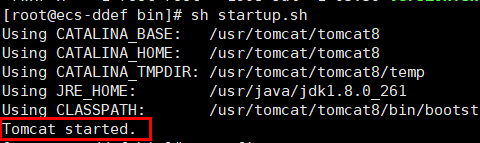

- Restart the Tomcat service.
cd /usr/tomcat/tomcat8/bin && sh shutdown.sh && sh startup.sh
/usr/tomcat/tomcat8/ is where Tomcat is installed. Change it based on site requirements.
Figure 5 Restarting the Tomcat service
- View the latest logs.
As highlighted in the following figure, IP addresses that are not in the IP address range starting with 100.125 are the source IP addresses.
cd /usr/tomcat/tomcat8/logs/ cat localhost_access_log..2021-11-29.txt
In this command, localhost_access_log..2021-11-29.txt indicates the log path of the current day. Change it based on site requirements.
Figure 6 Querying the source IP address

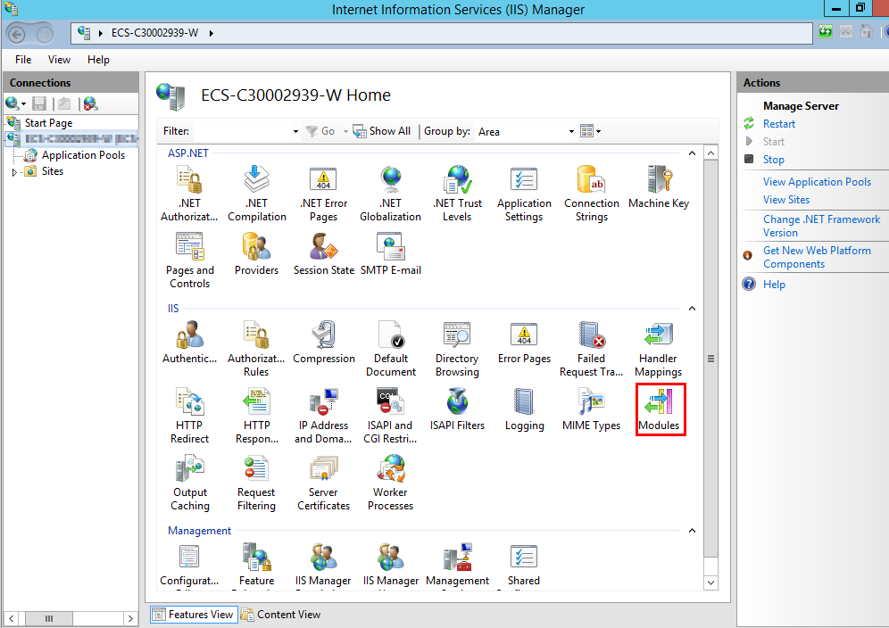

- Open the Server Manager and choose Modules > Configure Native Modules. Figure 7 Selecting modules
Figure 8 Configure Native Modules

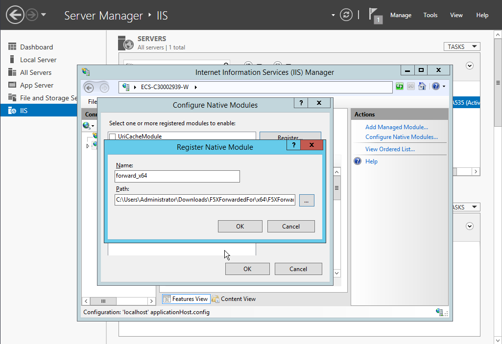

- Click Register to register the x86 and x64 plug-ins. Figure 9 Registering plug-ins

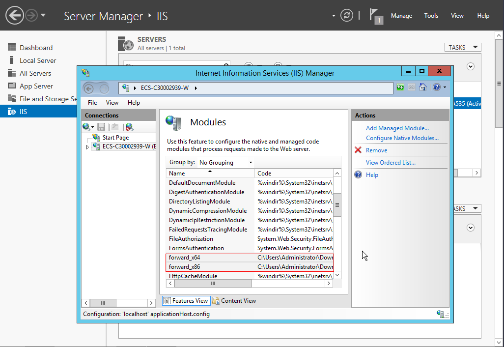

- In the Modules dialog box, verify that the registered plug-ins are displayed in the list. Figure 10 Confirming the registration

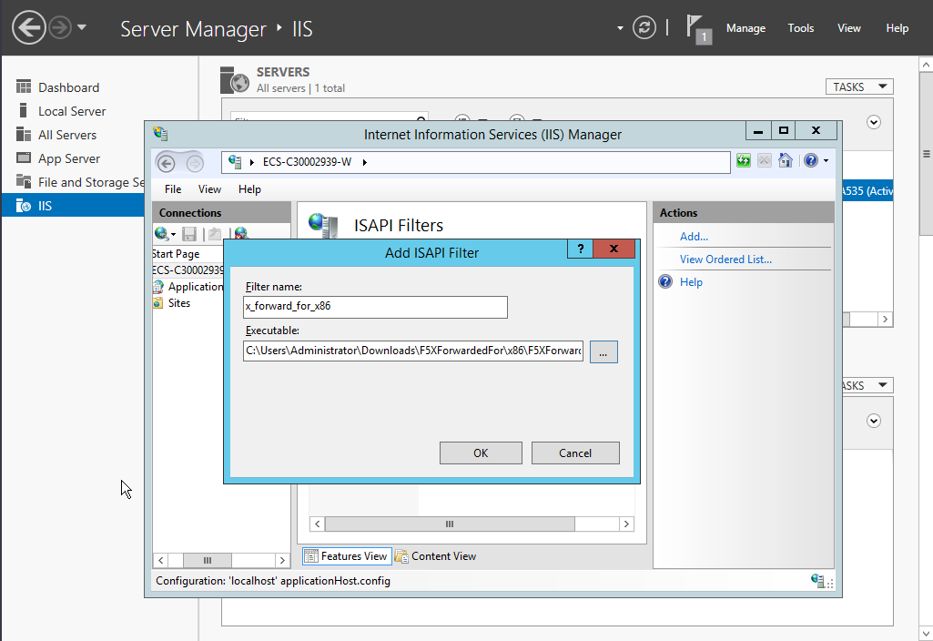

- Select ISAPI Filters on the Server Manager homepage and authorize two plug-ins to run ISAPI and CGI extensions. Figure 11 Adding authorization
- Select ISAPI and CGI Restriction to set the execution permission for the two plug-ins. Figure 12 Allowing the plug-ins to execute
