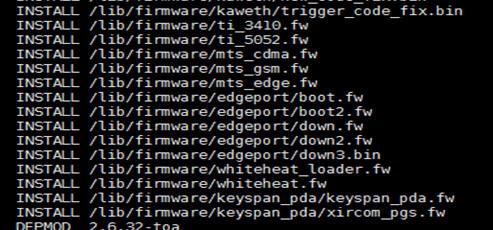

  5. Run the following command to install the module:
    make modules_install
    The following information is displayed.
    Figure 1 Installing the module

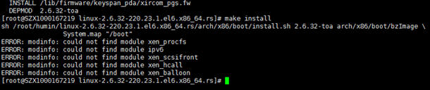

  6. Run the following command to install the kernel:
    make install
    Figure 2 Installing the kernel

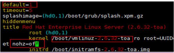

  7. Open the /boot/grub/grub.conf file and configure the kernel to start up when the system starts.
    1. Change the default startup kernel from the first kernel to the zeroth kernel by changing default=1 to default=0.
    2. Add the nohz=off parameter to the end of the line containing the vmlinuz-2.6.32-toa kernel. If nohz is not disabled, the CPU0 utilization may be high and overload the kernel.
      Figure 3 Configuration file
    3. Save the modification and exit. Restart the OS.
      During the restart, the system will load the vmlinuz-2.6.32-toa kernel.
