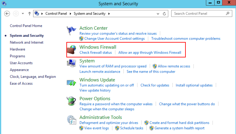

  1. Log in to the Windows ECS.
  2. Click the Windows icon in the lower left corner of the desktop and choose Control Panel > System and Security > Windows Firewall.

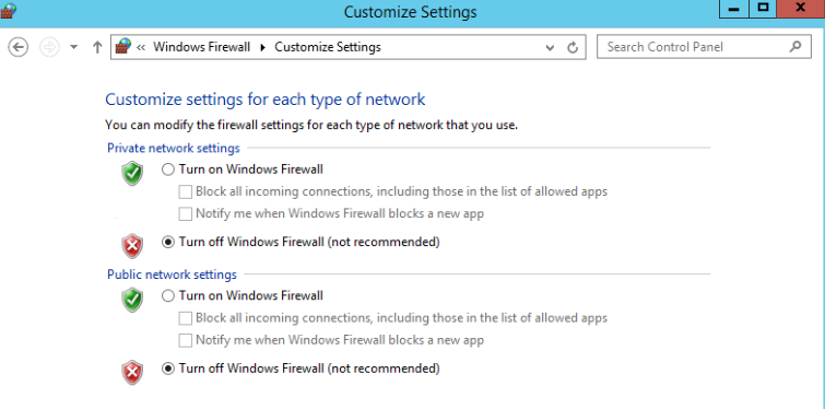

    Figure 2 Windows Firewall
  3. Click Check firewall status and select Turn on Windows Firewall or Turn off Windows Firewall.
    View and set the firewall status.
    Figure 3 Turning off a firewall
Ensure that the remote access port on the local end is allowed on the firewall. The default port is TCP 3389.
If the port configured in the inbound rule of the firewall is different from that configured on the remote server, the remote login will fail. If this occurs, add the port configured on the remote server in the inbound rule of the firewall.
The default port is 3389. If you use another port, add that port in the inbound rule of the firewall.
After you perform the preceding operations, try to remotely log in to the ECS again.

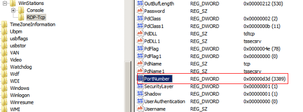

  2. Check whether the remote connection port is changed.
    1. Choose Start > Run, enter cmd, and press Enter. In the CLI, enter regedit to open Registry Editor.
    2. In HKEY_LOCAL_MACHINE\System\CurrentControlSet\Control\TerminalServer\WinStations\RDP Tcp\PortNumber, check whether the port is the default port 3389. If not, change the port to port 3389.

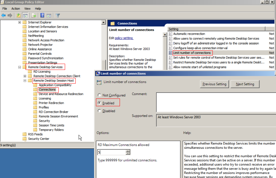

  3. Check whether the number of connections is limited.
    Check the internal remote desktop configuration of the ECS.
    1. Choose Start > Run, enter cmd, and press Enter. In the CLI, enter gpedit.msc to open Local Group Policy Editor.
    2. Choose Computer Configuration > Administrative Templates > Windows Components > Remote Desktop Services > Remote Desktop Session Host > Connections. Then, in the Limit number of connections dialog box, check whether the number of connections is limited.
      If Limit number of connections is set to Enabled, a remote connection to the Windows ECS may fail when the number of connections exceeds the limit. In such a case, disable Limit number of connections or set a larger limit for connections.
