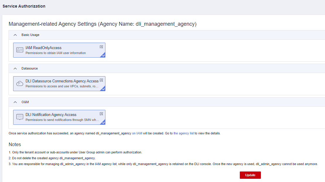

Check Whether the DLI Datasource Connections Agency Access Permission Is Granted to DLI
You can determine if a connection failure is due to insufficient permissions by checking the connection logs.
Figure 4 and Figure 5 show the logs when subnet ID and route ID of the destination cannot be obtained because there is no permission.
Solution: Add the DLI Datasource Connections Agency Access authorization on the Global Configuration > Service Authorization page.
