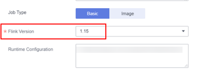

  • Flink OpenSource SQL job:
    1. Log in to the DLI management console.
    2. In the navigation pane on the left, choose Job Management > Flink Jobs. In the job list, locate the desired Flink OpenSource SQL job.
    3. Click Edit in the Operation column.
    4. On the Running Parameters tab, select a new Flink version for Flink Version.
      When running a job using Flink 1.15 or later, you need to configure agency information on the Runtime Configuration tab. The key should be flink.dli.job.agency.name and the value should be the name of the agency. Failure to do so may affect the job's execution. For how to customize DLI agency permissions, see .

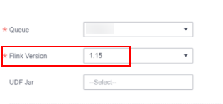

  • Flink Jar job:
    2. In the navigation pane on the left, choose Job Management > Flink Jobs. In the job list, locate the desired Flink Jar job.
    4. In the parameter configuration area, select a new Flink version for Flink Version.
      When running a job using Flink 1.15 or later, you need to configure agency information in Runtime Configuration. The key should be flink.dli.job.agency.name and the value should be the name of the agency. Failure to do so may affect the job's execution. For how to customize DLI agency permissions, see .

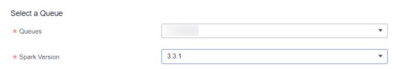

  • Spark Jar job:
    2. In the navigation pane on the left, choose Job Management > Flink Jobs. In the job list, locate the desired Spark Jar job.
    4. In the parameter configuration area, select a new Spark version for Spark Version.
      When running a job using Spark 3.3.1 or later, you need to configure a custom agency name in Spark Arguments(--conf). Failure to do so may affect the job's execution. For how to customize DLI agency permissions, see .
