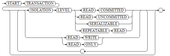

Format 1: START TRANSACTION
1 2 3 4 5 6 7 | START TRANSACTION [ { ISOLATION LEVEL { READ COMMITTED | READ UNCOMMITTED | SERIALIZABLE | REPEATABLE READ } | { READ WRITE | READ ONLY } } [, ...] ]; |

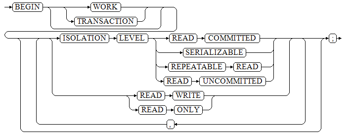

Format 2: BEGIN
1 2 3 4 5 6 7 | BEGIN [ WORK | TRANSACTION ] [ { ISOLATION LEVEL { READ COMMITTED | READ UNCOMMITTED | SERIALIZABLE | REPEATABLE READ } | { READ WRITE | READ ONLY } } [, ...] ]; |
