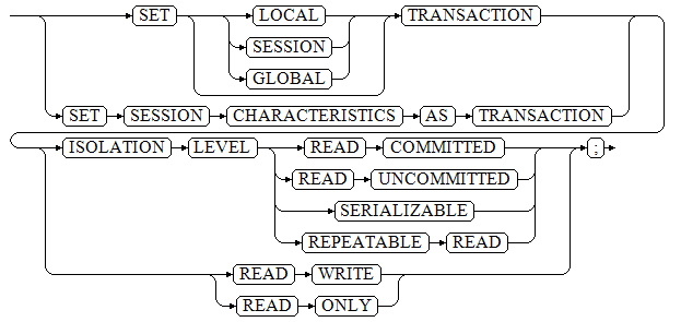

Syntax
1 2 3 4 | { SET [ LOCAL | SESSION ] TRANSACTION | SET SESSION CHARACTERISTICS AS TRANSACTION } { ISOLATION LEVEL { READ COMMITTED | READ UNCOMMITTED | SERIALIZABLE | REPEATABLE READ } | { READ WRITE | READ ONLY } }; |
Parameters
- LOCAL
Specifies that the specified statement takes effect only for the current transaction.
- SESSION
Specifies that the specified parameters take effect for the current session.
- ISOLATION LEVEL Specifies the transaction isolation level that determines the data that a transaction can view if other concurrent transactions exist.
- The isolation level cannot be changed after data is modified using INSERT, DELETE, UPDATE, FETCH, or COPY in the current transaction.
Value range:
- READ COMMITTED: Only committed data is read. This is the default value.
- READ UNCOMMITTED: After this isolation level is set, its behavior is the same as that of READ COMMITTED.
- REPEATABLE READ: Only the data committed before transaction start is read. Uncommitted data or data committed in other concurrent transactions cannot be read.
- SERIALIZABLE: Currently, this isolation level is not supported in GaussDB. It is equivalent to REPEATABLE READ.
- READ WRITE | READ ONLY
Specifies the transaction access mode (read/write or read only).
The access mode of the default transaction feature of the session can be set only when the database is started or by sending the HUP signal.
