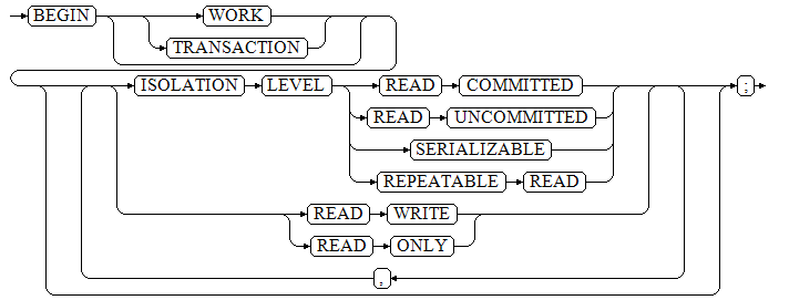

    BEGIN [ WORK | TRANSACTION ]
           ISOLATION LEVEL { READ COMMITTED | READ UNCOMMITTED | SERIALIZABLE | REPEATABLE READ }
           | { READ WRITE | READ ONLY }

  • WORK | TRANSACTION
    Specifies the optional keyword in the BEGIN syntax format without functions.
  • ISOLATION LEVEL
    Specifies the transaction isolation level that determines the data that a transaction can view if other concurrent transactions exist.
    The isolation level of a transaction cannot be reset after the first clause (INSERT, DELETE, UPDATE, FETCH, or COPY) for modifying data is executed in the transaction.
    Value range:
    • READ COMMITTED: Only committed data is read. This is the default value.
    • READ UNCOMMITTED: After this isolation level is set, its behavior is the same as that of READ COMMITTED.
    • REPEATABLE READ: Only the data committed before transaction start is read. Uncommitted data or data committed in other concurrent transactions cannot be read.
    • SERIALIZABLE: Currently, this isolation level is not supported. Setting this isolation level is equivalent to REPEATABLE READ.
  • READ WRITE | READ ONLY
    Specifies the transaction access mode (read/write or read only).
