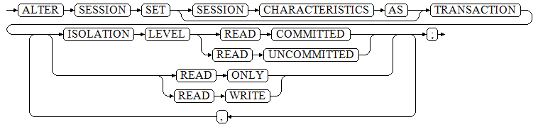

  • Set transaction parameters of a session.
    2
    ALTER SESSION SET [ SESSION CHARACTERISTICS AS ] TRANSACTION
        { ISOLATION LEVEL { READ COMMITTED | READ UNCOMMITTED } } | { READ ONLY  | READ WRITE } } [, ...] ;

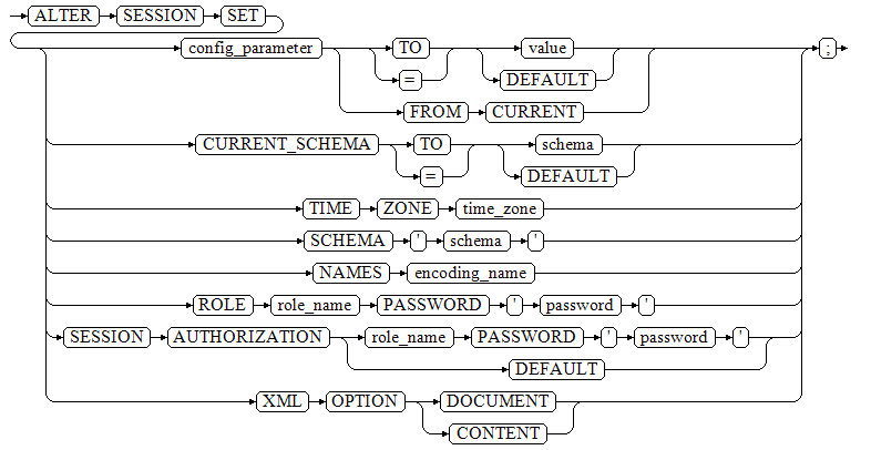

  • Set other GUC parameters of a session.
     2
     3
     4
     5
     6
     7
     8
     9
    10
    ALTER SESSION SET
        {{config_parameter { { TO  | =  }  { value | DEFAULT } | FROM CURRENT }}
          | CURRENT_SCHEMA { TO | = } { schema | DEFAULT }
          | TIME ZONE time_zone
          | SCHEMA 'schema'
          | NAMES encoding_name
          | ROLE role_name PASSWORD 'password'
          | SESSION AUTHORIZATION { role_name PASSWORD 'password' | DEFAULT }
          | XML OPTION { DOCUMENT | CONTENT }
