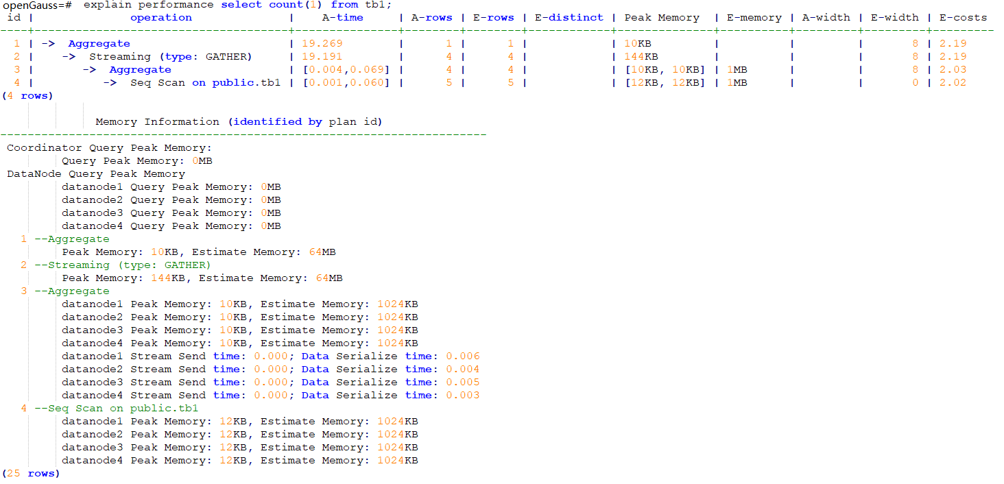

The output of running EXPLAIN PERFORMANCE is as follows:
This figure shows that the execution information can be classified into the following seven aspects.
- The plan is displayed as a table, which contains 11 columns: id, operation, A-time, A-rows, E-rows, E-distinct, Peak Memory, E-memory, A-width, E-width, and E-costs. The definition of the plan-type columns (columns started with id, operation, or E) is the same as that of running EXPLAIN. For details, see Execution Plans. The definition of A-time, A-rows, E-distinct, Peak Memory, and A-width are described as follows:
- A-time: execution completion time of the operator. Generally, A-time of the operator is two values enclosed with square brackets ([]), indicating the shortest time and longest time for completing the operator on all DNs, respectively.
- A-rows: number of actual output tuples of the operator
- E-distinct: estimated distinct value of the Hash Join operator
- Peak Memory: peak memory of the operator on each DN
- A-width: actual tuple width in each row of the current operator. This parameter is valid only for heavy memory operators, including (Vec)HashJoin, (Vec)HashAgg, (Vec)HashSetOp, (Vec)Sort, and (Vec)Materialize. The (Vec)HashJoin calculation width is the width of its right subtree operator and will be displayed on the right subtree.

- Memory Information (identified by plan id):
This part displays the memory usage information printed by certain operators (mainly Hash and Sort), including peak memory, control memory, operator memory, width, auto spread num, and early spilled; and spill details, including spill Time(s), inner/outer partition spill num, temp file num, spilled data volume, and written disk IO [min, max].

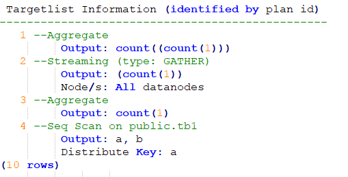

- Targetlist Information (identified by plan id):
This part displays the target columns provided by each operator.

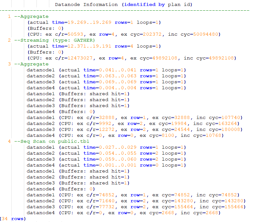

- DataNode Information (identified by plan id):
The execution time, CPU, and buffer usage of each operator are printed in this part.

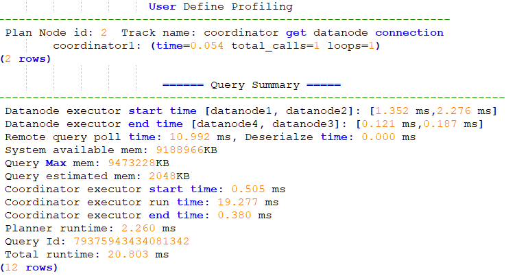

- User Define Profiling:
This part displays CNs and DNs, DN and DN connection time, and some execution information at the storage layer.
- ====== Query Summary =====:
The total execution time and network traffic, including the maximum and minimum execution time in the initialization and end phases on each DN, the time in the initialization, execution, and end phases on each CN, the system available memory and statement estimation memory information during the current statement execution, are printed in this part.
- The difference between A-rows and E-rows shows the deviation between the optimizer estimation and actual execution. Generally, if the deviation is larger, the plan generated by the optimizer is more improper, and more manual intervention and optimization are required.
- If the difference of the A-time values is larger, the operator computing skew (difference between execution time on different DNs) is larger, and more manual intervention and optimization are required.
- Max Query Peak Memory is often used to estimate the consumed memory of SQL statements, and is also used as an important basis for setting a running memory parameter during SQL statement optimization. Generally, the output from EXPLAIN ANALYZE or EXPLAIN PERFORMANCE is provided for the input for further optimization.
