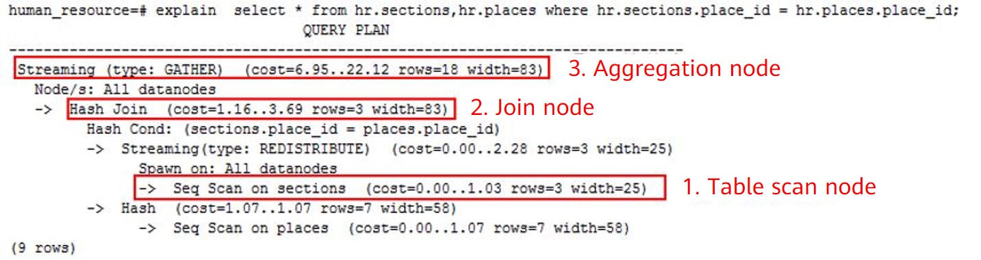

You can run the EXPLAIN command to view the execution plan generated for each query by an optimizer. The output of EXPLAIN has one row for each execution node, showing the basic node type and the cost estimation that the optimizer made for the execution of this node, as shown in Figure 1.
Figure 1 SQL execution plan example
  • Nodes at the bottom level are scan nodes. They scan tables and return raw rows. The types of scan nodes (sequential scans and index scans) vary depending on the table access methods. Objects scanned by the bottom layer nodes may not be row-store data (not directly read from a table), such as VALUES clauses and functions that return rows, which have their own types of scan nodes.
  • If the query requires join, aggregation, sorting, or other operations on the raw rows, there will be other nodes above the scan nodes to perform these operations. In addition, there is more than one way to perform these operations, so different types of execution nodes may be displayed here.
  • The first row (the upper-layer node) estimates the total execution cost of the execution plan. Such an estimate indicates the value that the optimizer tries to minimize.

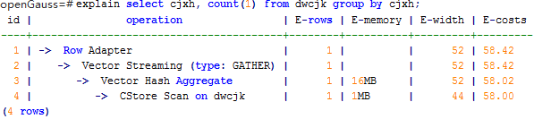

  • pretty indicates that the optimized display mode of GaussDB is used. A new format contains a plan node ID, directly and effectively analyzing performance, as shown in Figure 2.

Figure 2 Example of an execution plan using the pretty format
You can change the display format of execution plans by setting explain_perf_mode. Later examples use the pretty format by default.
