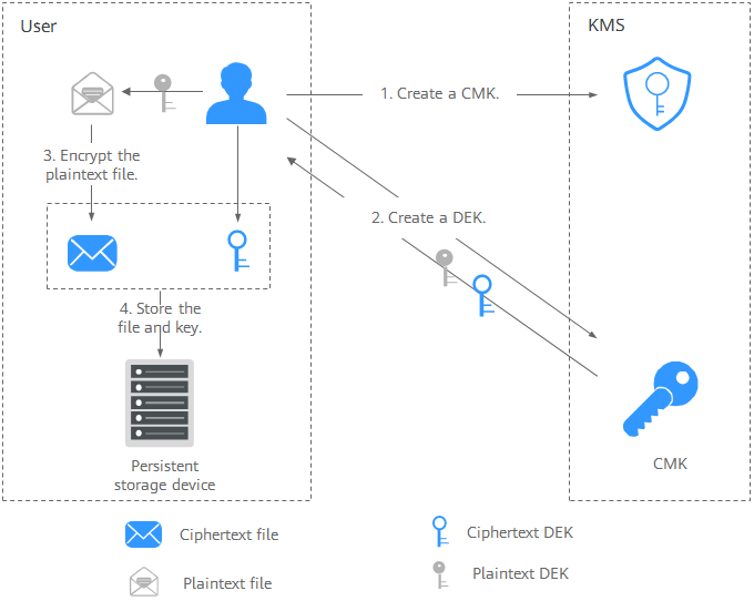

- Figure 1 illustrates the process for encrypting a local file.
The procedure is as follows:
- Create a CMK on KMS.
- Call the create-datakey API of KMS to create a DEK. Then you get a plaintext DEK and a ciphertext DEK. The ciphertext DEK is generated when you use a CMK to encrypt the plaintext DEK.
- Use the plaintext DEK to encrypt the file. A ciphertext file is generated.
- Save the ciphertext DEK and the ciphertext file together in a persistent storage device or a storage service.

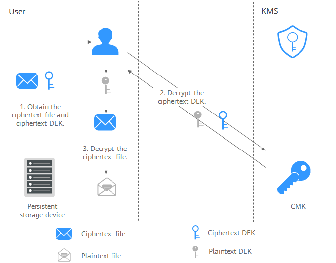

- Figure 2 illustrates the process for decrypting a local file.
- Obtain the ciphertext DEK and file from the persistent storage device or the storage service.
- Call the decrypt-datakey API of KMS and use the corresponding CMK (the one used for encrypting the DEK) to decrypt the ciphertext DEK. Then you get the plaintext DEK.
If the CMK is deleted, the decryption fails. Therefore, properly keep your CMKs.
- Use the plaintext DEK to decrypt the ciphertext file.
