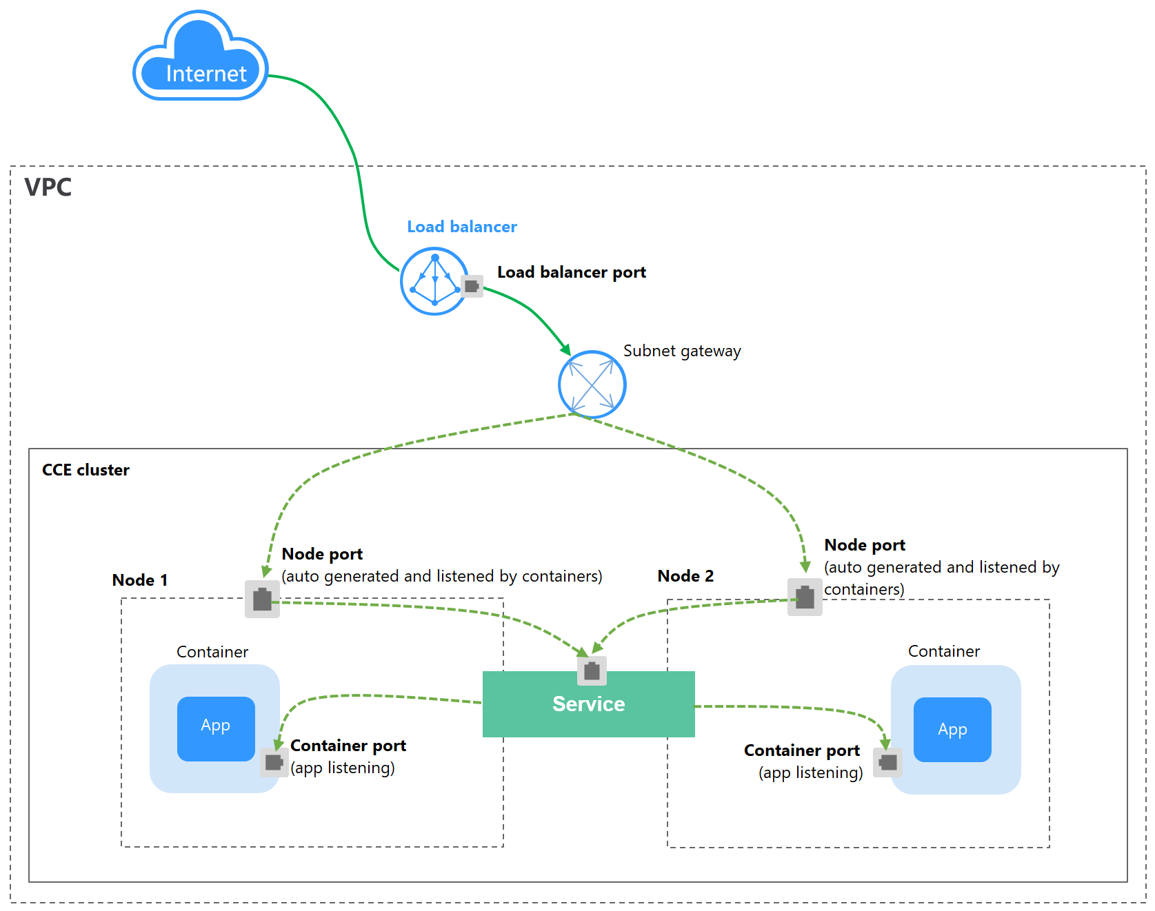

Creating a LoadBalancer Service
A LoadBalancer Service adds an external load balancer on the top of a NodePort Service and distributes external traffic to multiple pods within a cluster. A LoadBalancer Service provides higher reliability than a NodePort Service. It automatically assigns an external IP address to allow access from the clients. LoadBalancer Services process TCP and UDP traffic at Layer 4 (transport layer) as well as HTTP and HTTPS traffic at Layer 7 (application layer).
If cloud applications require a stable, easy-to-manage entry for external access, you can create a LoadBalancer Service. For example, in a production environment, you can use LoadBalancer Services to expose public-facing services, such as web applications and API services, to the Internet. These services often need to handle heavy traffic while maintaining high availability. The access address of a LoadBalancer Service is in the format of {EIP-of-load-balancer}:{access-port}, for example, 10.117.117.117:80.

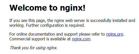

You can configure LoadBalancer Service access using kubectl when creating a workload. If you already have a load balancer in the same VPC and want to use it as the application access entry when creating a Service in the cluster, follow the following steps to associate the load balancer with the Service:
- Use kubectl to access the cluster. For details, see Accessing a Cluster Using kubectl.
- Create and edit the nginx-deployment.yaml file to configure the sample workload. For details, see Creating a Deployment. nginx-deployment.yaml is an example file name. You can rename it as needed.
vi nginx-deployment.yaml
File content:apiVersion: apps/v1 kind: Deployment metadata: name: nginx spec: replicas: 1 selector: matchLabels: app: nginx template: metadata: labels: app: nginx spec: containers: - image: nginx:latest name: nginx imagePullSecrets: - name: default-secret - Create and edit the nginx-elb-svc.yaml file to configure Service parameters. nginx-elb-svc.yaml is an example file name. You can rename it as needed.
vi nginx-elb-svc.yaml
File content:
apiVersion: v1 kind: Service metadata: name: nginx annotations: kubernetes.io/elb.id: <your_elb_id> # Load balancer ID. Replace it with the actual value. kubernetes.io/elb.class: # Load balancer type kubernetes.io/elb.lb-algorithm: ROUND_ROBIN # Load balancer algorithm kubernetes.io/elb.session-affinity-mode: SOURCE_IP # The sticky session type is source IP address. kubernetes.io/elb.session-affinity-option: '{"persistence_timeout": "30"}' # Stickiness duration, which is measured in minutes kubernetes.io/elb.health-check-flag: 'on' # Enable ELB health check. kubernetes.io/elb.health-check-option: '{ "protocol":"TCP", "delay":"5", "timeout":"10", "max_retries":"3" }' spec: selector: app: nginx ports: - name: service0 port: 80 # Port for accessing the Service, which is also the listener port on the load balancer. protocol: TCP targetPort: 80 # Port used by a Service to access the target container. This port is closely related to the applications running in a container. nodePort: 31128 # Port number of the node. If this parameter is not specified, a random port number ranging from 30000 to 32767 is generated. type: LoadBalancer
To enable sticky sessions, ensure anti-affinity is configured for the workload pods so that the pods are deployed onto different nodes. For details, see Configuring Workload Affinity or Anti-affinity Scheduling (podAffinity or podAntiAffinity).
The preceding example uses annotations to implement some advanced functions of load balancing, such as sticky session and health check. For details, see Table 3.
For more annotations and examples related to advanced functions, see Configuring Advanced Load Balancing Functions Using Annotations.

- Enter the URL in the address box of the browser, for example, 10.78.42.242:80. 10.78.42.242 indicates the IP address of the load balancer, and 80 indicates the access port displayed on the CCE console.
The Nginx is accessible.
Figure 3 Accessing Nginx through the LoadBalancer Service
