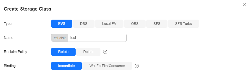

- Log in to the CCE console and click the cluster name to access the cluster console.
- Choose Storage in the navigation pane. In the right pane, click the Storage Classes tab. Click Create Storage Class in the upper right corner. In the dialog box displayed, configure parameters.
Figure 1 Create StorageClass
Parameter |
Description |
Type |
The type of the underlying storage. |
Name |
The StorageClass name. The name of a StorageClass must be unique within a cluster. |
Reclaim Policy |
The policy for reclaiming the underlying storage when the PVC is deleted. For details, see PV Reclaim Policy.
- Delete: When a PVC is deleted, its associated underlying storage resources are deleted and the PV resources are removed. Exercise caution if you select this option.
- Retain: When a PVC is deleted, the associated PV and underlying storage resources are retained and need to be manually deleted.
Binding |
When a PV is dynamically created, either immediately or with a delay.
- Immediate: When a PVC is created, the storage resources and PV are created and bound to the PVC immediately, without delay. Local PVs do not support Immediate.
- WaitForFirstConsumer: When a PVC is created, it is not immediately bound to a PV. Instead, the storage resources and PV are created and bound to the PVC only after the pod that requires the PVC is scheduled. OBS, SFS, and SFS Turbo do not support WaitForFirstConsumer.
- Click Create. On the Storage Classes tab page, view the created StorageClass and its information.
