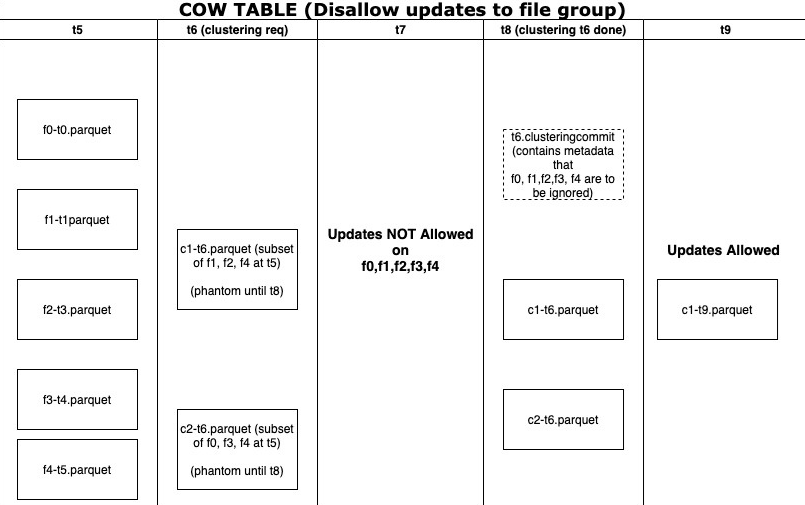

The clustering service can run asynchronously or synchronously. It adds a new operation type called REPLACE, which will mark the clustering operation in the Hudi metadata timeline.
Clustering service is based on the MVCC design of Hudi to allow new data to be inserted. Clustering operations run in the background to reformat data layout, ensuring snapshot isolation between concurrent readers and writers.

- Group files that are eligible for clustering based on specific criteria. The data size of each group must be a multiple of targetFileSize. Grouping is a part of the strategy defined in the plan. Additionally, there is an option to control group size to improve parallelism and avoid shuffling large volumes of data.
- Save the clustering plan to the timeline in Avro metadata format.
- Execute clustering: Process the plan using an execution strategy to create new files and replace old files.
- Read the clustering plan and obtain clusteringGroups that marks the file groups to be clustered.
- Instantiate appropriate strategy class for each group using strategyParams (for example, sortColumns) and apply the strategy to rewrite data.
- Create a REPLACE commit and update the metadata in HoodieReplaceCommitMetadata.

- Clustering does not support concurrency with upsert (write operation updates files waiting for clustering). If clustering is inflight, files under that FileGroup cannot be updated.
