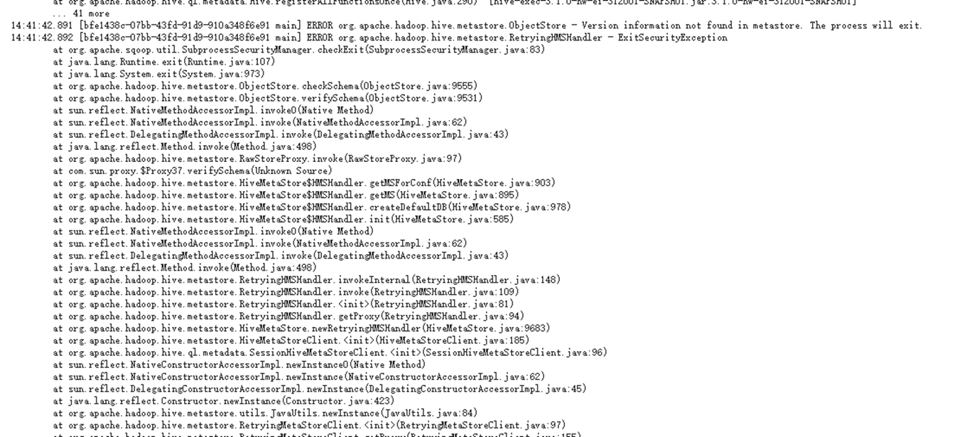

Question
An error is reported when data is synchronized in hive-table mode.
Answer
Add the following content to the hive-site.xml file.
