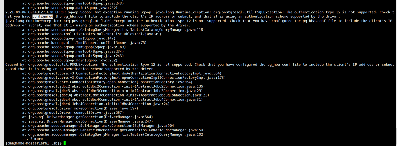

    The sqoop command can be executed to query PostgreSQL tables, but an error is reported when the sqoop import command is executed.
    The authentication type 5 is not supported. Check that you have configured the pg_hba.conf file to include the client's IP address or subnet, and that it
    The authentication type 12 is not supported. Check that you have configured the pg_hba.conf file to include the client's IP address or subnet, and that it

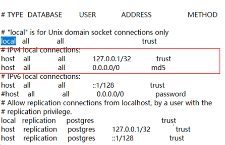

    • If the authentication type is 12, the root cause is as follows: The pg_hba.conf file of the database is incorrectly configured.
  • Answer:
    • If the authentication type is 5, the solution is as follows: Move the driver package gsjdbc4-*.jar to the tmp directory on each node where MRS NodeManager instance is deployed.
      mv ${BIGDATA_HOME}/FusionInsight_HD_*/1_*_NodeManager/install/hadoop/share/hadoop/common/lib/gsjdbc4-*.jar /tmp
    • If the authentication type is 12, the solution is as follows: Modify the pg_hba.conf file of the database by changing the value of ADDRESS to the IP address of the node where Sqoop resides.
