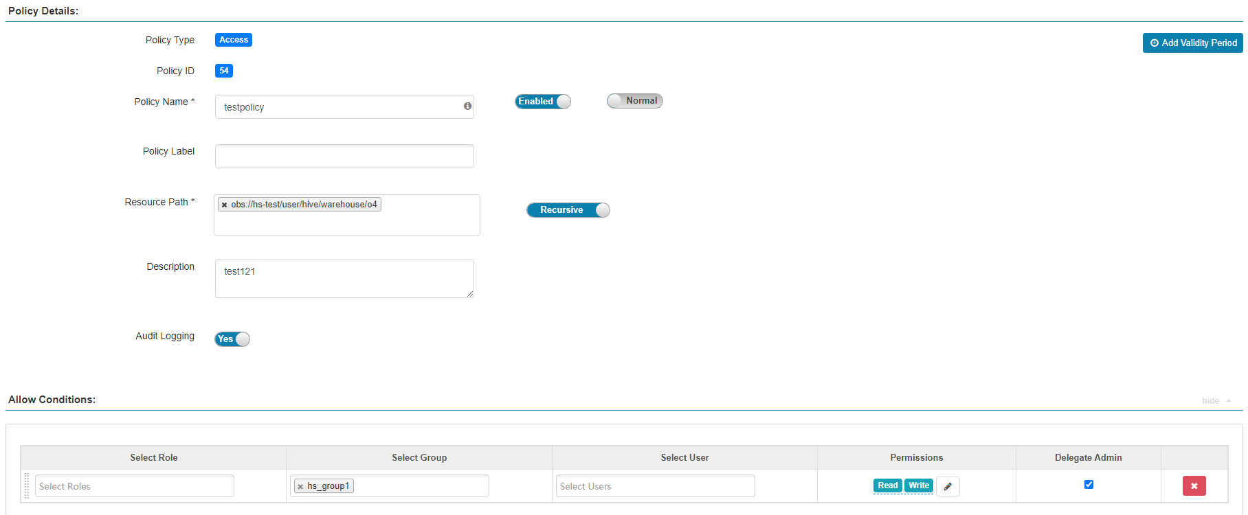

In the Select Group column, select the created user group to which you want to grant permissions. (The configuration of Select Role or Select User does not take effect.)
Click Add Permissions to add permissions.
- Read: permission to read data
- Write: permission to write data
- Select/Deselect All: permission to select or deselect all
To add multiple permission control rules, click
. To delete a permission control rule, click
.To give user group hs_group1 the read and write access to the obs://hs-test/user/hive/warehouse/o4 table, follow the following configuration steps. Note that user group names can only contain up to 52 characters, including numbers (0 to 9), letters (A to Z or a to z), underscores (_), and number signs (#). Otherwise, the policy will fail to add.
