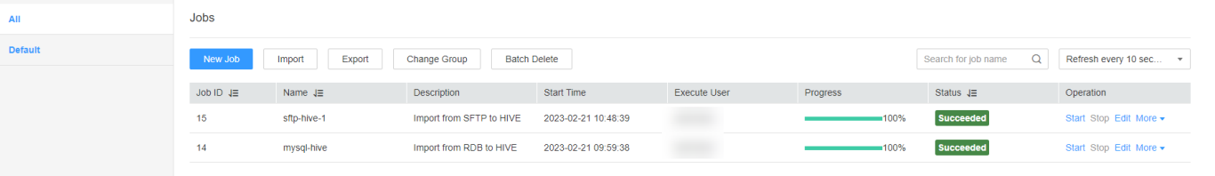

- Access the Loader web UI.
- Log in to FusionInsight Manager.
- Choose Cluster > Services > Loader.
- Click LoaderServer(Node name, Active). The Loader web UI is displayed.
Figure 1 Loader web UI

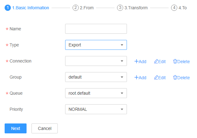

- Click New Job. Configure basic job parameters on the Basic Information page displayed.
Figure 2 Basic Information page
- Enter a job name in Name.
- Set Type to Export.
- Set Group to the group to which the job belongs. There is no group created by default. Click Add, enter the group name, and click OK.
- Set Queue to the Yarn queue that executes the job. The default value is root.default.
- Set Priority to the priority of the Yarn queue that executes the job. The default value is NORMAL. The options are VERY_LOW, LOW, NORMAL, HIGH, and VERY_HIGH.
- In the Connection area, click Add to create a connection, set Connector to generic-jdbc-connector, set connection parameters, and click Test to verify whether the connection is available. When "Test Success" is displayed, click OK.
