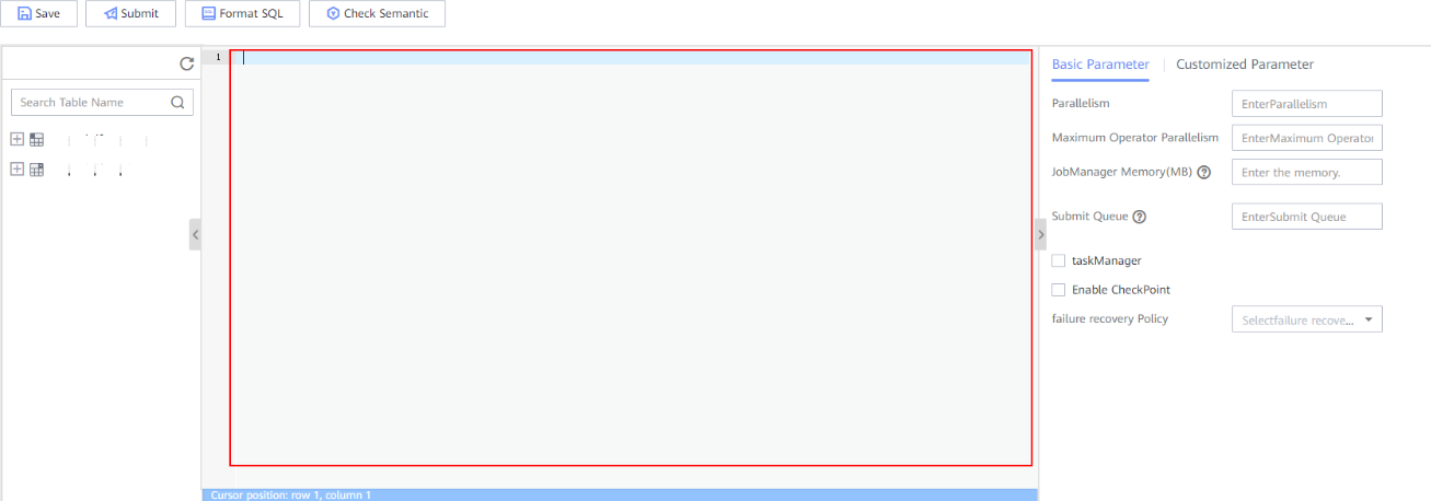

      1. Develop the job on the job development page.
        Figure 1 FlinkServer job development page
      2. Click Check Semantic to check the input content and click Format SQL to format SQL statements.
      3. Set basic and customized parameters as required by referring to Table 1 and click Save.
