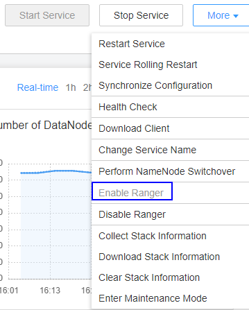

- Log in to FusionInsight Manager. For details, see Accessing FusionInsight Manager. Choose Cluster > Services > Name of the service for which Ranger authentication is enabled.
- In the upper right corner of the Dashboard page, click More and select Enable Ranger. In the displayed dialog box, enter the password and click OK. After the operation is successful, click Finish.
- If Enable Ranger is dimmed, Ranger authentication is enabled. See Figure 1.
- For components (except HDFS and YARN) for which Ranger authorization has been enabled, the permissions of non-default roles on Manager do not take effect. You need to configure Ranger policies to assign permissions to user groups.
- Perform a rolling service restart or restart the service.
