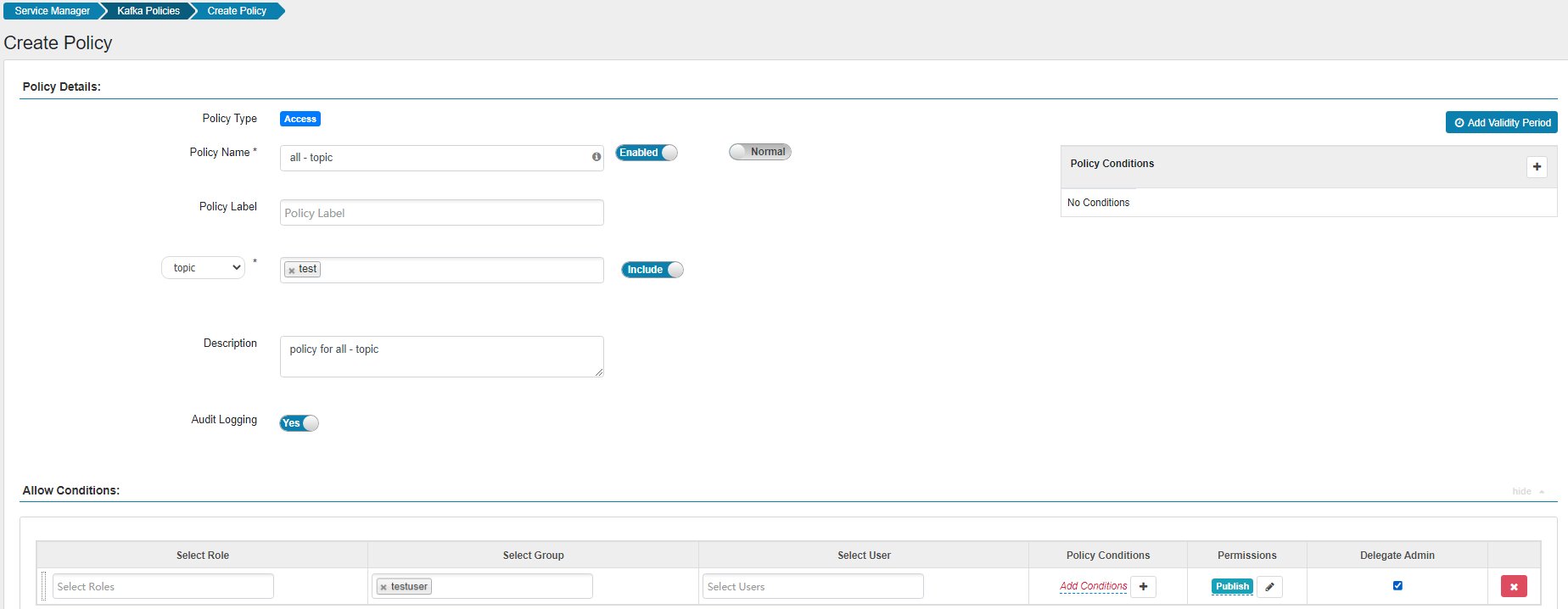

For example, to add the production permission for the test topic of user testuser, configure the following information:
Figure 1 Kafka permission parameters

to edit the policy. - In consumergroup, configure the consumer group to be managed.
- In the Allow Conditions area, select a user from the Select User drop-down list.
- Click Add Permissions and select Delete.
NOTE:When a user is granted with the Delete permission of ConsumerGroup, the user is also granted with the Describe permission.
- (Optional) Add the validity period of the policy. Click Add Validity period in the upper right corner of the page, set Start Time and End Time, and select Time Zone. Click Save. To add multiple policy validity periods, click
. To delete a policy validity period, click
. - Click Add to view the basic information about the policy in the policy list. After the policy takes effect, check whether the related permissions are normal.
