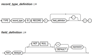

Perform the following operations to create a record variable:
Define a record type and use this type to declare a variable.
Syntax
For the syntax of the record type, see Figure 1.
The above syntax diagram is explained as follows:
- record_type: record name
- field: record columns
- datatype: specifies data types for the member variables.
- expression: specifies the expression for setting a default value.
