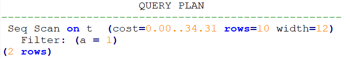

Forcibly use the custom plan.
1 2 3 | create table t (a int, b int, c int); prepare p as select /*+ use_cplan */ * from t where a = $1; explain execute p(1); |
In the following plan, the filter condition is the actual value of the input parameter, that is, the plan is a custom plan.

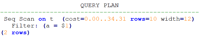

Forcibly use the generic plan.
1 2 3 | deallocate p; prepare p as select /*+ use_gplan */ * from t where a = $1; explain execute p(1); |
In the following plan, the filter condition is the input parameter to be added. That is, the plan is a generic plan.
