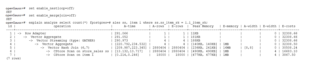

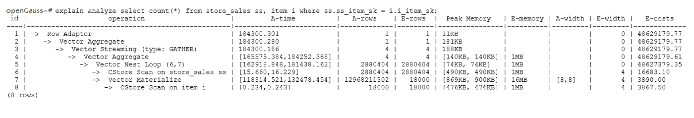

Example 2: If a nested-loop join is used for joining tables with a large number of rows, the join may take a long time. In the following example, the nested loop takes 181s. If enable_mergejoin is set to off to disable merge join and enable_nestloop is set to off to disable the nested loop so that the optimizer selects hash join, the join takes more than 200 ms.

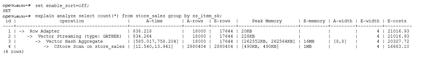

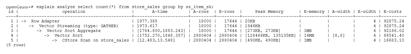

Example 3: Generally, query performance can be improved by selecting HashAgg. If Sort and GroupAgg are used for a large result set, you need to set enable_sort to off. HashAgg consumes less time than Sort and GroupAgg.
