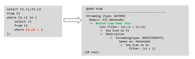

  • Sublink-release scenarios supported by GaussDB
    • Non-correlated IN sublink
      • The subquery cannot contain columns in the outer query (columns in more outer queries are allowed).
      • The subquery cannot contain volatile functions.
      Example:
      Replace the execution plan on the right of the arrow with the following execution plan:
      QUERY PLAN
      Hash Join
      Hash Cond: (t1.c1 = t2.c2)
      ->  Seq Scan on t1
      ->  Hash
      ->  HashAggregate
      Group By Key: t2.c2
      ->  Seq Scan on t2
      Filter: (c1 = 1)
      (8 rows)

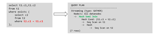

    • Correlated EXISTS sublink
      The WHERE clause must contain a column in the outer query. Other parts of the subquery cannot contain the column. Other restrictions are as follows:
      • The subquery must contain the FROM clause.
      • The subquery cannot contain the WITH clause.
      • The subquery cannot contain aggregate functions.
      • The subquery cannot contain a SET, SORT, LIMIT, WindowAgg, or HAVING operation.
      Example:
      QUERY PLAN
      Hash Join
      Hash Cond: (t1.c1 = t2.c1)
      ->  Seq Scan on t1
      ->  Hash
      ->  HashAggregate
      Group By Key: t2.c1
      ->  Seq Scan on t2
      (7 rows)

More Optimization Examples
Example: Modify the SELECT statement by modifying the subquery to a join relationship between the main table and the parent query or modifying the subquery to improve the query performance. Ensure that the subquery to be used is semantically correct.
2
3
4
5
6
7
8
9
openGauss=# explain (costs off) select * from t1 where t1.c1 in (select t2.c1 from t2 where t1.c1 = t2.c2);
           QUERY PLAN
 Seq Scan on t1
   Filter: (SubPlan 1)
   SubPlan 1
     ->  Seq Scan on t2
           Filter: (t1.c1 = c2)
(5 rows)
In the preceding example, a subplan is used. To remove the subplan, you can modify the statement as follows:
 2
 3
 4
 5
 6
 7
 8
 9
10
11
12
openGauss=# explain (costs off) select * from t1 where exists (select t2.c1 from t2 where t1.c1 = t2.c2 and t1.c1 = t2.c1);
                QUERY PLAN
 Hash Join
   ->  Seq Scan on t1
   ->  Hash
         ->  HashAggregate
               Group By Key: t2.c2, t2.c1
               ->  Seq Scan on t2
                     Filter: (c2 = c1)
(8 rows)
In this way, the subplan is replaced by the hash-join between the two tables, greatly improving the execution efficiency.
