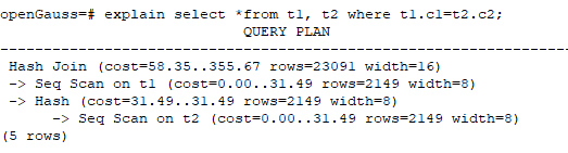

You can run the EXPLAIN command to view the execution plan generated for each query by an optimizer. The output of EXPLAIN has one row for each execution node, showing the basic node type and the cost estimation that the optimizer made for the execution of this node. For details, see Figure 1.

An example of an execution plan using the pretty format is as follows:
explain select * from t1,t2 where t1.c1=t2.c2;
id | operation | E-rows | E-width | E-costs
1 | -> Hash Join (2,3) | 23091 | 16 | 58.353..355.674
2 | -> Seq Scan on t1 | 2149 | 8 | 0.000..31.490
3 | -> Hash | 2149 | 8 | 31.490..31.490
4 | -> Seq Scan on t2 | 2149 | 8 | 0.000..31.490
(4 rows)
Predicate Information (identified by plan id)
1 --Hash Join (2,3)
Hash Cond: (t1.c1 = t2.c2)
(2 rows) You can change the display format of execution plans by setting the GUC parameter explain_perf_mode. Later examples use the pretty format by default.
