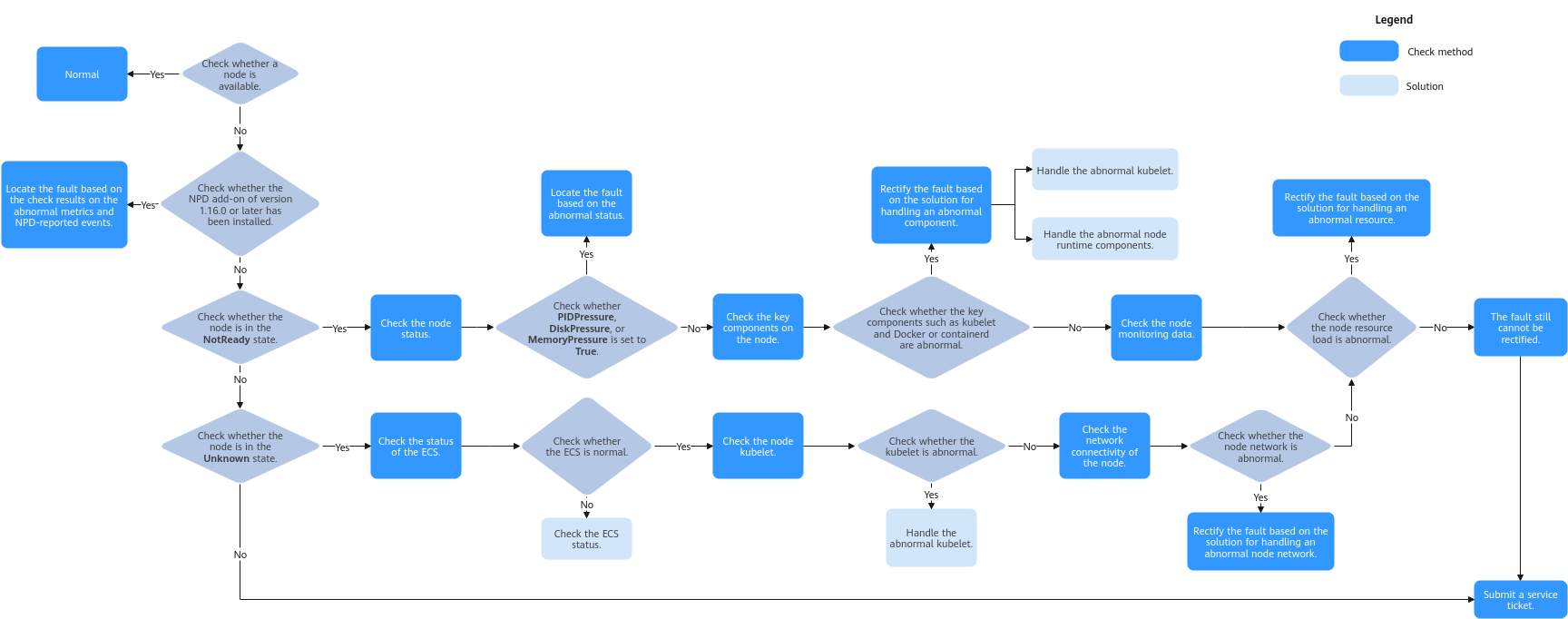

Locating a Node Fault by Performing a Self-Check
- Log in to the CCE console.
- Click the cluster name to access the cluster console. Choose Nodes in the navigation pane. In the right pane, click the Nodes tab.

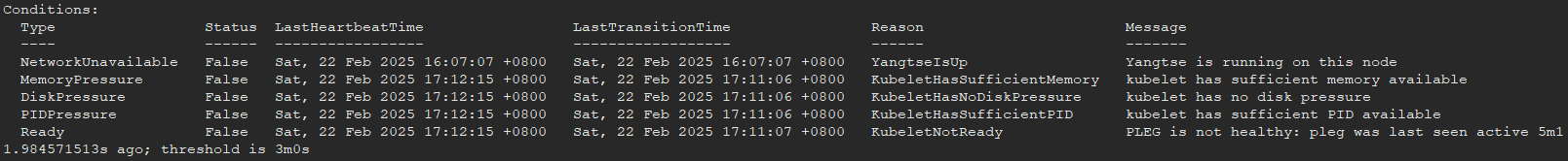

- Locate the row containing the target node, choose More > View YAML in the Operation column, and check the Status field of the node.
The node is in the NotReady state.
- Check the node status and verify whether the value of PIDPressure, DiskPressure, or MemoryPressure becomes True. If any of them becomes True, you can find the appropriate solution based on the exception keyword.
- Check the key components on the node and the logs of these components. The key components on a node include a kubelet and the node runtime (Docker or containerd). For details, see Checking Key Components of the Node.
- Check the kubelet.
Check whether the kubelet and its logs are normal. If there is an exception, see Abnormal kubelet.

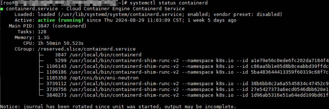

- Check the runtime (Docker or containerd).
- Check the runtime of the node. If you are not sure whether the runtime is Docker or containerd, log in to the CCE console and view the runtime of the node.
- If there is an exception, see Abnormal Runtime.

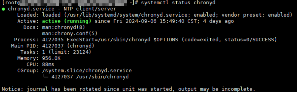

- Check the NTP.
- Check whether the NTP, its logs, and the configurations are normal.
- If there is an exception, see Abnormal NTP.
- Check the node monitoring data and see whether the CPU, memory, and network resources of the node are normal. If there is an exception, rectify the fault by referring to Memory Pressure.
The node is in the Unknown state.
- Log in to the ECS console and check whether the node is present in the ECS list.
- Check whether the node is running properly.
- Check whether the kubelet and its logs are normal. If there is an exception, see Abnormal kubelet.
- Check the network connectivity of the node.

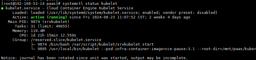

kubelet
Log in to the target node, run the following command on it, and check the kubelet:
systemctl status kubelet
The expected output is shown in the figure below.
- View the kubelet logs.
journalctl -u kubelet

systemctl restart kubelet
- Check whether the kubelet status becomes normal:
- If the kubelet status is still abnormal after the restart, log in to the node and view the kubelet logs:
- If there are error messages in the logs, find the cause by looking for specific keywords associated with the error.
- If there is an issue with the kubelet configuration, find the node pool that the node belongs to, click Manage in the Operation column, and make changes to the kubelet configuration.

- Log in to the abnormal node.
- Restart the runtime:
# Docker systemctl restart docker # containerd systemctl restart containerd
- After the command is executed, check whether the running status is normal.
# Docker systemctl status docker # containerd systemctl status containerd
- If the component status is still abnormal after the restart, check the component logs:
# Docker journalctl -u docker # containerd journalctl -u containerd

Solution
- Log in to the abnormal node and restart chronyd:
systemctl restart chronyd
- After the restart, check whether the chronyd status becomes normal:
systemctl status chronyd
- If the chronyd status is still abnormal after the restart, log in to the node and view the chronyd logs:
journalctl -u chronyd

Abnormal PLEG
Possible Cause
The pod lifecycle event generator (PLEG) records different events in the lifecycle of a pod, such as the pod startup and termination. The error "PLEG is not healthy" is usually due to abnormal runtime processes on the node or issues with the systemd version on the node.
Symptom
- The node is in the NotReady state.
- You can see the following information in the kubelet logs:
skipping pod synchronization - PLEG is not healthy: pleg was last seen active 3m17.028393648s ago; threshold is 3m0s.
Solution
- Restart Docker or containerd and kubelet in sequence and then check whether the node is restored.
- If the node is not restored after the restart of the key components, restart the node. (Be cautious when restarting the node because it may cause interruptions to your services.)

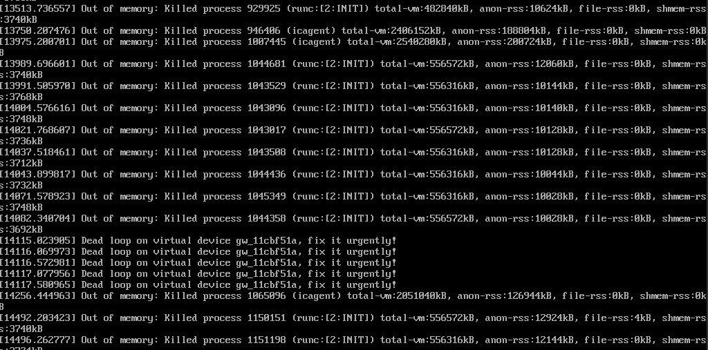

Node Unavailable Due to OOM
Possible Cause
Many containers are scheduled onto a node, using up all its resources and causing an OOM issue. This issue is primarily seen on nodes running the Docker container engine.
Symptom
If a node in the cluster is assigned too many containers, the node OS might crash, rendering the node unavailable. You may see the information similar to the following after logging in to the node with VNC.
Check the node events:
kubectl describe node {nodeName} Pay attention to the abnormal node events in the output.
Solution
If the resources on a node are not enough for pod scheduling, reduce the node load through either of the following ways:
- Reset the faulty node.
- Delete unnecessary pods.
- Restrict the resource configurations of pods based on service requirements.
- Add more nodes to the cluster.
