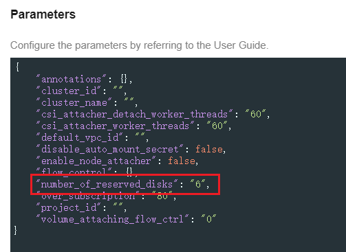

CCE Container Storage (Everest) 2.3.11 or later supports number_of_reserved_disks, which is used to configure the number of disks reserved on a node. By configuring this parameter, you can reserve disk slots for your nodes. Note that the modification of this parameter applies to all nodes in a cluster.
After number_of_reserved_disks is configured, the number of the additional EVS disks that can be attached to a node is calculated as follows:
Number of remaining disks attached to a node= Maximum number of EVS disks that can be attached to the node - Value of number_of_reserved_disks
If the maximum number of EVS disks that can be attached to a node is 20 and number_of_reserved_disks is set to 6, the number of the additional EVS disks that can be attached to the node is 14 (20 – 6 = 14) when a workload with EVS disks attached needs to be scheduled. The reserved six disks include one system disk and one data disk that have been attached to the node. You can attach four EVS disks to this node as additional data disks or raw disks for a local storage pool. In this scenario, if 18 workload pods, each with one EVS disk attached, need to be scheduled in the cluster, the node can accept 14 workload pods at most. The remaining four workload pods will be scheduled to other nodes in the cluster. In this way, the problem that the storage volume mount failure will not occur.
