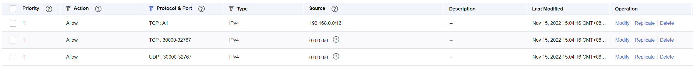

  • Check the node security group of the cluster and ensure that the service ports in the range of 30000 to 32767 are accessible to all network segments for inbound traffic.

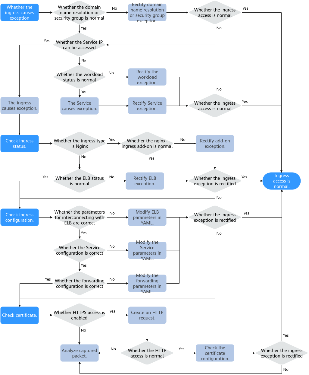

This section provides an overview of troubleshooting ingress external access exceptions, as shown in Figure 1.
Figure 1 Fault locating overview
  1. Checking Whether the Exception Is Caused by the Ingress
    Check whether the problem is caused by the ingress. Ensure that the external domain name resolution is normal, the security group rules are correct, and the service and workload corresponding to the ingress are working properly.
  2. Checking the Ingress Status
    When the service and workload are normal, ensure that the load balancer on which the ingress depends is normal. If the ingress is of the Nginx type, ensure that the NGINX Ingress Controller add-on runs properly.
  3. Checking Whether the Ingress Is Configured Correctly
    If the preceding check results are normal, the ingress configuration may be incorrect.
    • Check whether the parameters for interconnecting with the load balancer are correct.
    • Check whether the Service configuration is correct.
    • Check whether the forwarding configuration is correct.
  4. Checking Certificate
    If HTTPS access is enabled on the ingress, you also need to check whether the fault is caused by incorrect certificate configuration. You can use the same load balancer to create an HTTP ingress. If the access is normal, the HTTPS certificate may be faulty.
  5. If the fault persists, capture packets for analysis or submit a service ticket for help.

    2. Check the security group rules of the cluster nodes and ensure that the service ports in the 30000–32767 range are accessible to all network segments for inbound traffic. For details about how to harden the security group, see How Can I Configure a Security Group Rule for a Cluster?

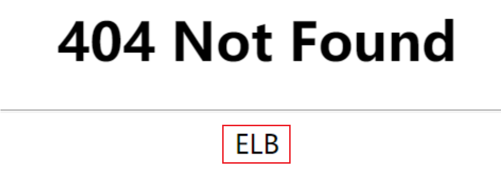

    You can also determine whether the fault is caused by the load balancer based on the error code. If the following error code is displayed, there is a high probability that the fault is caused by the load balancer. In this case, you need to pay special attention to the load balancer.
