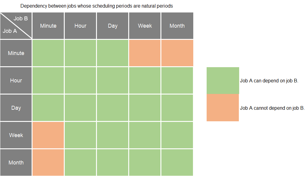

The natural periods for job scheduling can be classified into the following types: minute, hour, day, week, or month. Figure 1 lists the scheduling periods that can be configured for the dependency jobs of jobs with different scheduling periods.
