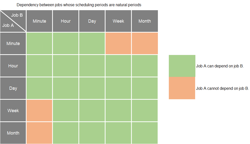

Introduction
Job A depends on Job B which has the same scheduling period as job A. The period unit can be minute, hour, day, week, or month. Figure 1 lists the scheduling periods that can be configured for the dependency jobs of jobs with different scheduling periods.

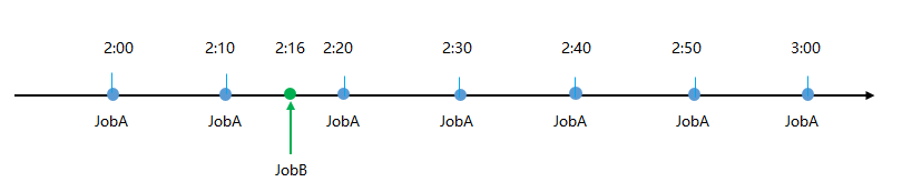

Example: Minute-level job A depends on hourly job B. Job A is triggered every 10 minutes, and job B is executed at the 16th minute of each hour. In this case, job A is executed after job B is executed in the previous period.

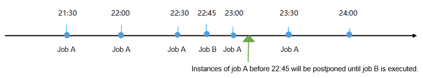

A Minute-Level Job Depends on a Daily Job
Rule: A minute-level job which depends on a daily job is executed only after the daily job is executed.
Example: Job A depends on job B. Job A is executed every 30 minutes, and job B is executed at 22:45. All the instances of job A before 22:45 will be executed after job B is executed.

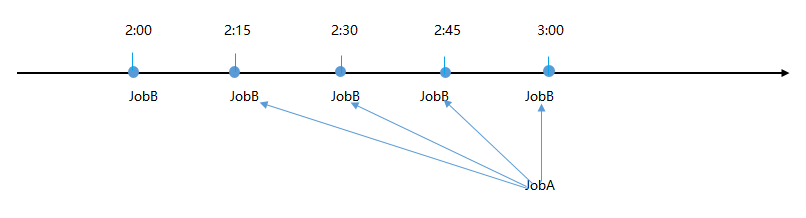

An Hourly Job Depends on a Minute-Level Job

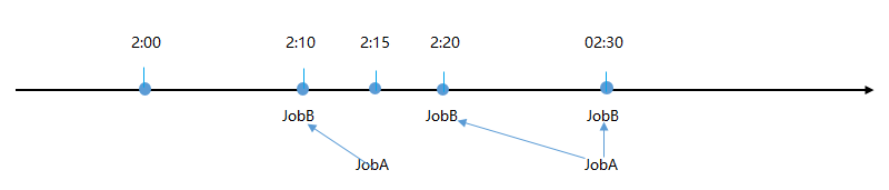

Rule: An hourly job depends on a minute-level job. All the minute-level job instances within the last natural hour are executed The range is (2:00,3:00].
Example 1: Job A depends on job B. Job A is an hourly job and is executed at the top of each hour. Job B is executed every 15 minutes. After job B is executed, job A is executed. Job A depends on the instances of job B within an hour. For example, job A executed at 03:00 depends on four instances of job B, which are generated at 02:15, 02:30, 02:45, and 03:00, respectively.
- If you select Recent when configuring job dependency, the hourly job depends only on the latest running instance of the selected job. For example, if job A starts at 03:00, it depends on the instance of job B which is executed at 02:45.
- If job A is scheduled at 00:00, it can depend on job B which is a minute-level job of yesterday.

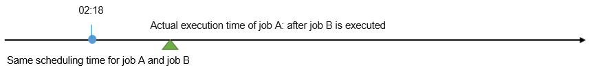

An Hourly Job Depends on Another Hourly Job
Rule: Instances in each calendar hour depend on each other. The range boundary is the calendar hour [00:00, 00:59].
Example 1: Job A depends on job B. In the same calendar hour, job A is always executed after job B regardless of when they are executed.

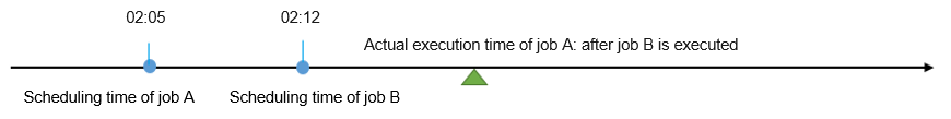

Example 2: Job A depends on job B. Job A is executed at the fifth minute of each hour, and job B is executed at the 12th minute of each hour. A is executed after B is executed.

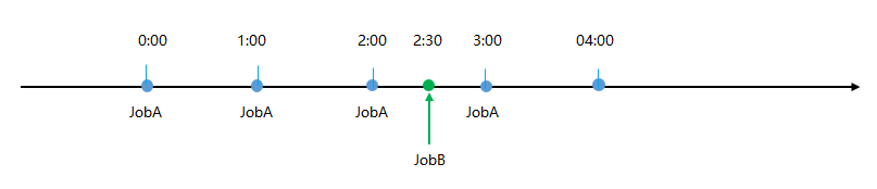

Rule: An hourly job which depends on a daily job is executed only after the daily job is executed.
Example: Job A depends on job B. Job A is executed at the top of each hour, and job B is executed at 02:30. All the instances of job A before 02:30 will be executed after job B is executed.

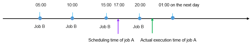

A Daily Job Depends on an Hourly Job
Rule: Instances of a daily job depend on the instances of all hourly jobs within a day. Job A is a daily job and depends on job B. Job A depends on all instances of job B on a calendar day. Job A is executed after the last instance of job B is executed.
Example: Job A depends on job B. If job A is scheduled at 17:00 every day and job B is executed every five hours starting from 00:00, job A is executed after the instance of job B is executed at 20:00.
If you select Recent when configuring job dependency, the daily job depends only on the latest running instance of the selected job. For example, if job A is scheduled at 17:00 every day, it depends on the instance of job B which is executed at 15:00.

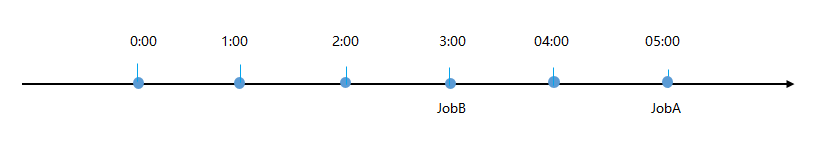

A Daily Job Depends on Another Daily Job
Rule: Jobs depend only on instances on the same calendar day. If job A depends on job B within the same calendar day, job A is always executed after job B regardless of their execution time. The day range is [00:00:00,23:59:59].

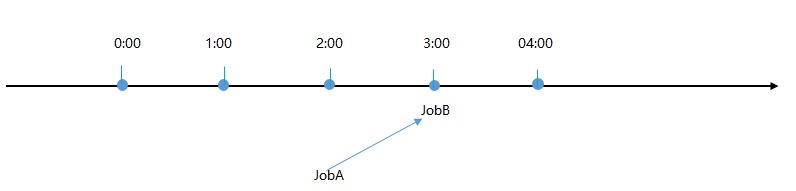

Example 1: Job A depends on job B. Job A is executed at 02:00, and job B is executed at 03:00. Job A is executed after job B is executed at 03:00.
Example 2: Job A depends on job B. Job A is executed at 05:00, and job B is executed at 03:00. Job A is executed at 05:00 after job B is executed.

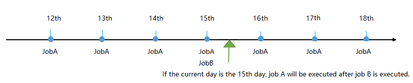

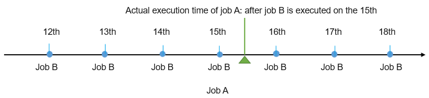

A Daily Job Depends on a Monthly Job
Rule: A daily job depends on a monthly job executed on the current day. If the monthly job is not executed on the current day, the daily job is directly executed. If the monthly job is executed on the current day, the daily job will be executed after the monthly job is executed.
Example: Job A depends on job B. Job A is executed once a day, and job B is executed once on the 15th day of each month. If the current day is not the 15th day, job B is not executed, no instance is generated for job B, and job A is directly executed. If the current day is the 15th day, job A will be executed after job B is executed.

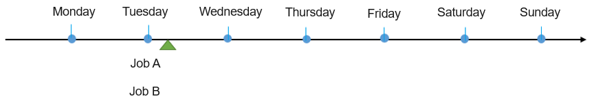

A Weekly Job Depends on a Daily Job

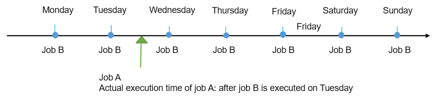

Rule: Weekly jobs depend only on jobs scheduled and executed on the same day.
Example: Job A depends on job B. Job A is scheduled to be executed on Tuesday, and job B is executed every day. On Tuesday, Job A is executed after job B is executed.
