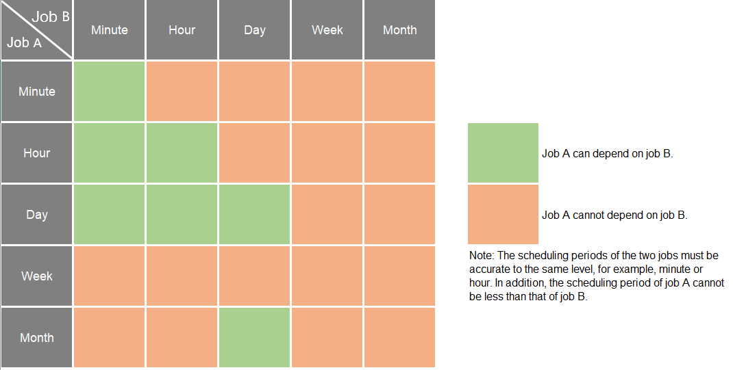

In the traditional periodic scheduling dependency mode, jobs with the same same period can depend on each other, or jobs with a longer period can depend on those with a shorter period. Jobs with a shorter period cannot depend on those with a longer period. The details are as follows:
- Same-period dependency: The dependency time range is one period earlier than the current batch time.
- Cross-period dependency: The dependency time range is within the previous period. Figure 1 Dependency between jobs with traditional periods
- Rule 1: Infer the dependency between daily and hourly jobs by calendar day and hour.
- Rule 2: Infer the dependency between weekly and monthly jobs based on the calendar day of the current day.
- Rule 3: Jobs with a longer period depend only on the last job with a shorter period. For example, daily jobs depend on hourly jobs.
Calendar day: [00:00:00–23:59:59]
Calendar hour: [00:00–59:59]

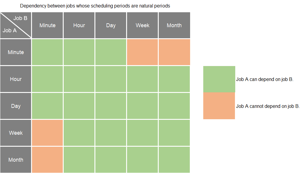

Figure 2 Dependency between jobs with natural periods

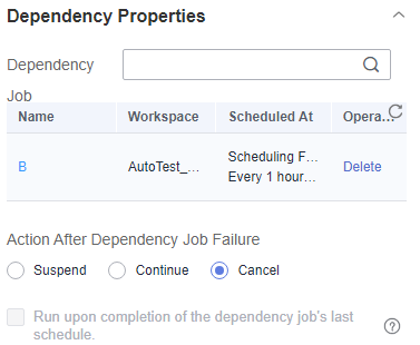

Job A is scheduled by hour, and job B is scheduled by day.
- When job A is being associated with a dependency job, if job B can be selected, the natural periodic scheduling dependency mode is used. (Jobs with a shorter period can depend only those with a longer period.)
- When job A is being associated with a dependency job, if job B cannot be selected, the traditional periodic scheduling dependency mode is used. (Jobs with a shorter period cannot depend only those with a longer period.) Figure 3 Job dependency
