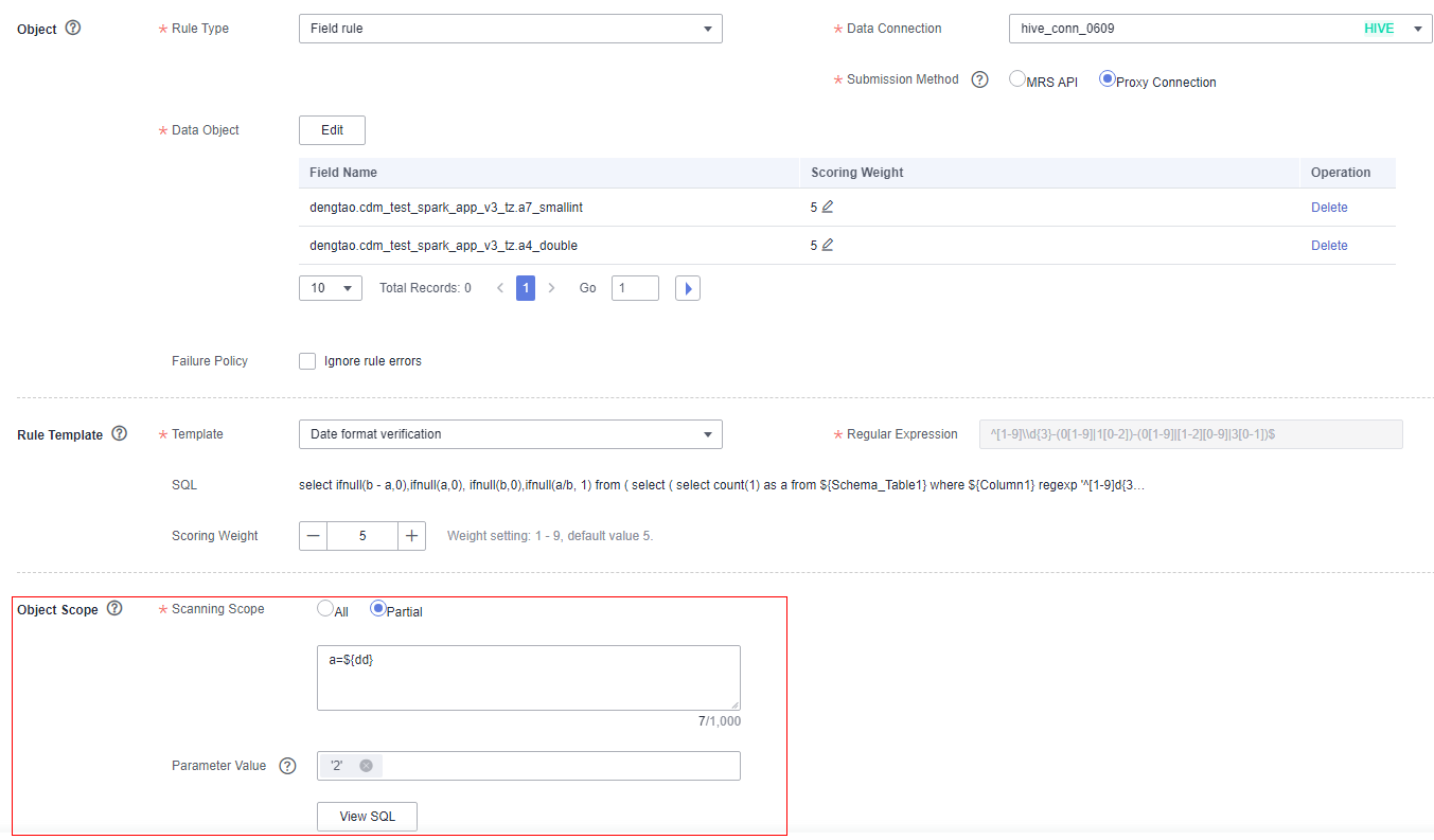

- Click Next. On the Define Rule page, configure rules for the quality job. In the Object Scope area, set Scanning Scope to Partial and configure parameters. Figure 1 Configuring parameters for the data quality job

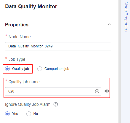

- Drag a Data Quality Monitor operator to the canvas and configure node properties. Figure 2 Configuring properties for the Data Quality Monitor node

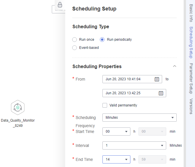

- Configure the scheduling information. Figure 3 Configuring the scheduling information
