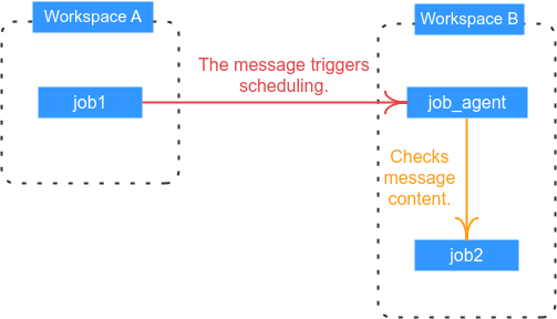

The DataArts Studio DataArts Factory module supports job running triggered by events. Therefore, MRS Kafka can be used as the job dependency to implement cross-workspace job scheduling.
As shown in the following figure, after job1 in workspace A is complete, you can use Kafka Client to send a message to trigger job_agent for which event-driven scheduling has been configured. After job_agent is triggered by the message sent by Kafka Client, job_agent checks whether the message meets the expectation. If yes, job2 is triggered. If no, job2 is not triggered.

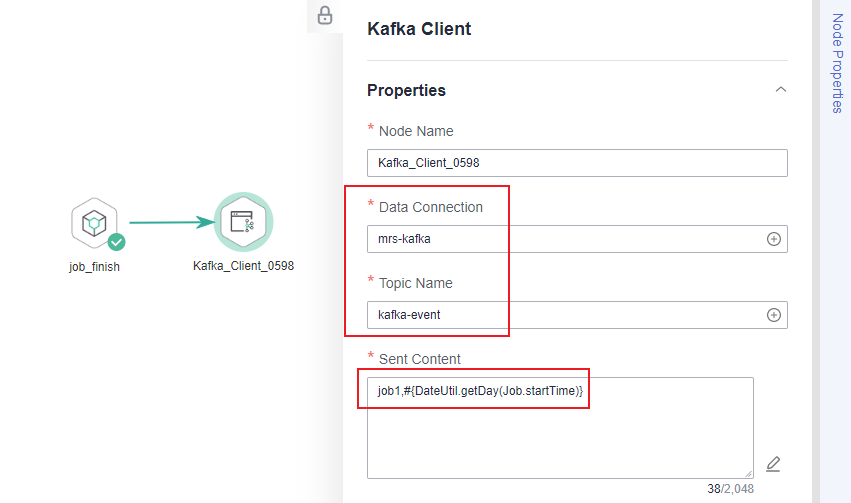

  2. Locate the row that contains a workspace and click DataArts Factory in the Quick Entry column. On the displayed page, create a job named job1. Drag a Dummy node and a Kafka Client node and drop them on the canvas, and click and hold to connect the nodes, as shown in Figure 2.
    • The Dummy node does not perform any operation. In this example, the Dummy node is only used for demonstration. You can replace it with another node.
    • The Kafka Client node is used to send messages. You need to select a Kafka connection and a topic name, and set Sent Content to the EL expression job1,#{DateUtil.getDay(Job.startTime)}. After the job is executed, the Kafka Client node sends a string message job1,Job execution date. For example, if job1 was executed on February 15, the message is job1,15.
    • Retain the default values of other job parameters.

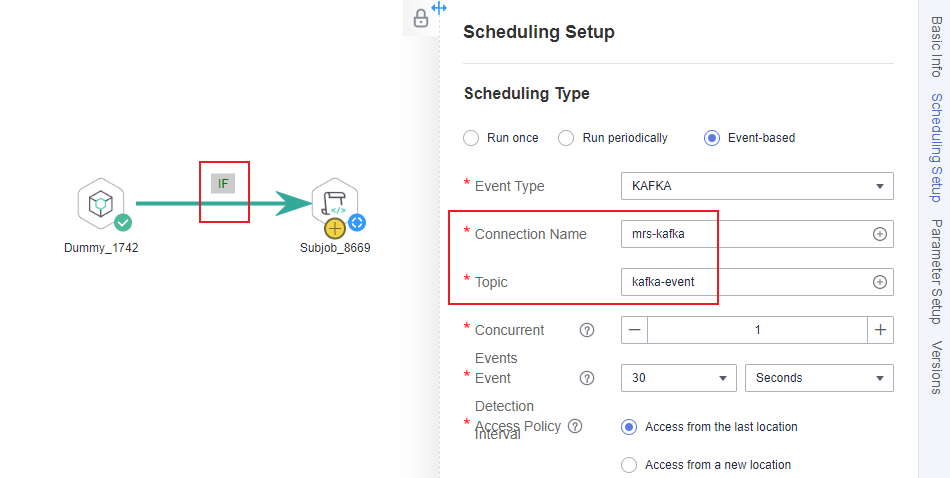

  3. In workspace B, create a job named job_agent. Drag a Dummy node and a Subjob node and drop them on the canvas, and click and hold to connect the nodes, as shown in Figure 3.
    Figure 3 Scheduling settings for job_agent
    • The Dummy node does not perform any operation. In this example, the Dummy node is used to set the IF condition for the connection between the Dummy node and the Subjob node.
    • The Subjob node is used to reference and execute job2 as a subjob. In practice, you can reference an existing job or use another job node to replace the Subjob node.
    • Set Scheduling Type to Event-based, and set Connection Name and Topic to the Kafka connection and topic in workspace B, which correspond to the Kafka connection and topic selected for the Kafka Client node of job1 in workspace A. The connection and topic are used to trigger job execution through Kafka messages.
    • Set the IF condition to check whether the message sent by the Kafka Client node meets the expectation. If yes, the Subjob node will be executed. Otherwise, the Subjob node will be skipped.

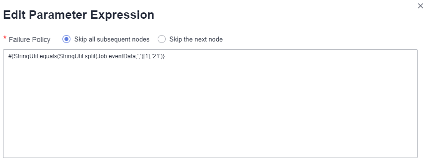

      Right-click the connection line and select Set Condition. In the Edit Parameter Expression dialog box, enter the IF condition in the text box and retain the default failure policy. The IF condition is a ternary expression based on the EL expression syntax. The node following the connection line will be executed only if the result of the ternary expression is true. Otherwise, subsequent nodes will be skipped.
      #{StringUtil.equals(StringUtil.split(Job.eventData,',')[1],'21')}
      This IF condition indicates that subsequent job nodes are executed only if 21 (21st of each month) follows the comma in the message obtained from the Kafka stream.

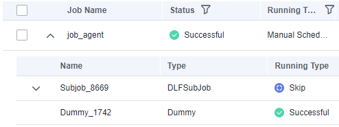

  4. Run the job_agent job when job1 in workspace A is not running. Then go to the Monitor Instance page and check whether the execution result meets the expectation.
    Because job1 is not running, no message is sent, and the Subjob node in the job_agent job is skipped, indicating that the IF condition takes effect.

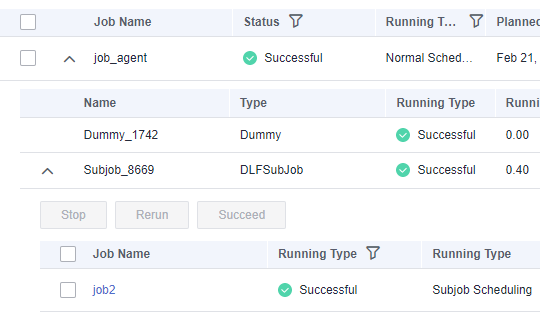

  5. Start scheduling the job_agent job. Then run job1 in workspace A. After job1 is successfully executed, go to the Monitor Instance page of workspace B to check whether the job execution result meets the expectation.
    • The job_agent job is triggered.
    • If the current date matches the date in the IF condition, the Subjob node in the job_agent job is successfully executed, and job2 is also successfully executed. Otherwise, the Subjob node is skipped.
