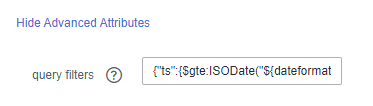

When creating a table/file migration job and selecting the link to MongoDB or DDS as the source link, you can set the query filters in advanced attributes.
You can set this parameter to a macro variable of date and time, for example, {"ts":{$gte:ISODate("${dateformat(yyyy-MM-dd'T'HH:mm:ss.SSS'Z',-1,DAY)}")}}, which indicates searching for the values in the ts field that are greater than those after time macro conversion, that is, only the data generated after the previous day is exported.
After this parameter is set, CDM exports only the data generated on the previous day. In addition, you can set the job to be executed at 00:00:00 every day, so that the data generated every day can be incrementally synchronized.
