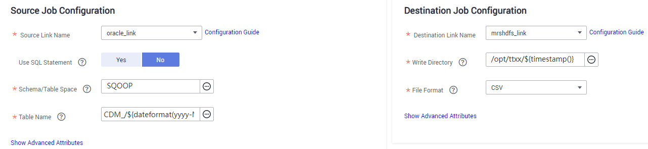

Time and Date Macro Variables of Paths and Table Names
Figure 1 shows an example. If:
  • Table Name under Source Link Configuration is set to CDM_/${dateformat(yyyy-MM-dd)}.
  • Write Directory under Destination Link Configuration is set to /opt/ttxx/${timestamp()}.
After the macro definition conversion, this job indicates that data in table SQOOP.CDM_20171016 in the Oracle database is migrated to the /opt/ttxx/1508115701746 directory of the HDFS server.
Figure 1 Setting Table Name and Write Directory to a time and date macro variable
Currently, a table name or path name can contain multiple macro variables. For example, /opt/ttxx/${dateformat(yyyy-MM-dd)}/${timestamp()} is converted to /opt/ttxx/2017-10-16/1508115701746.
