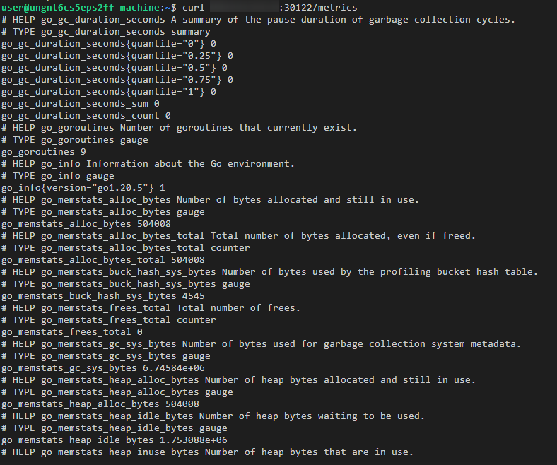

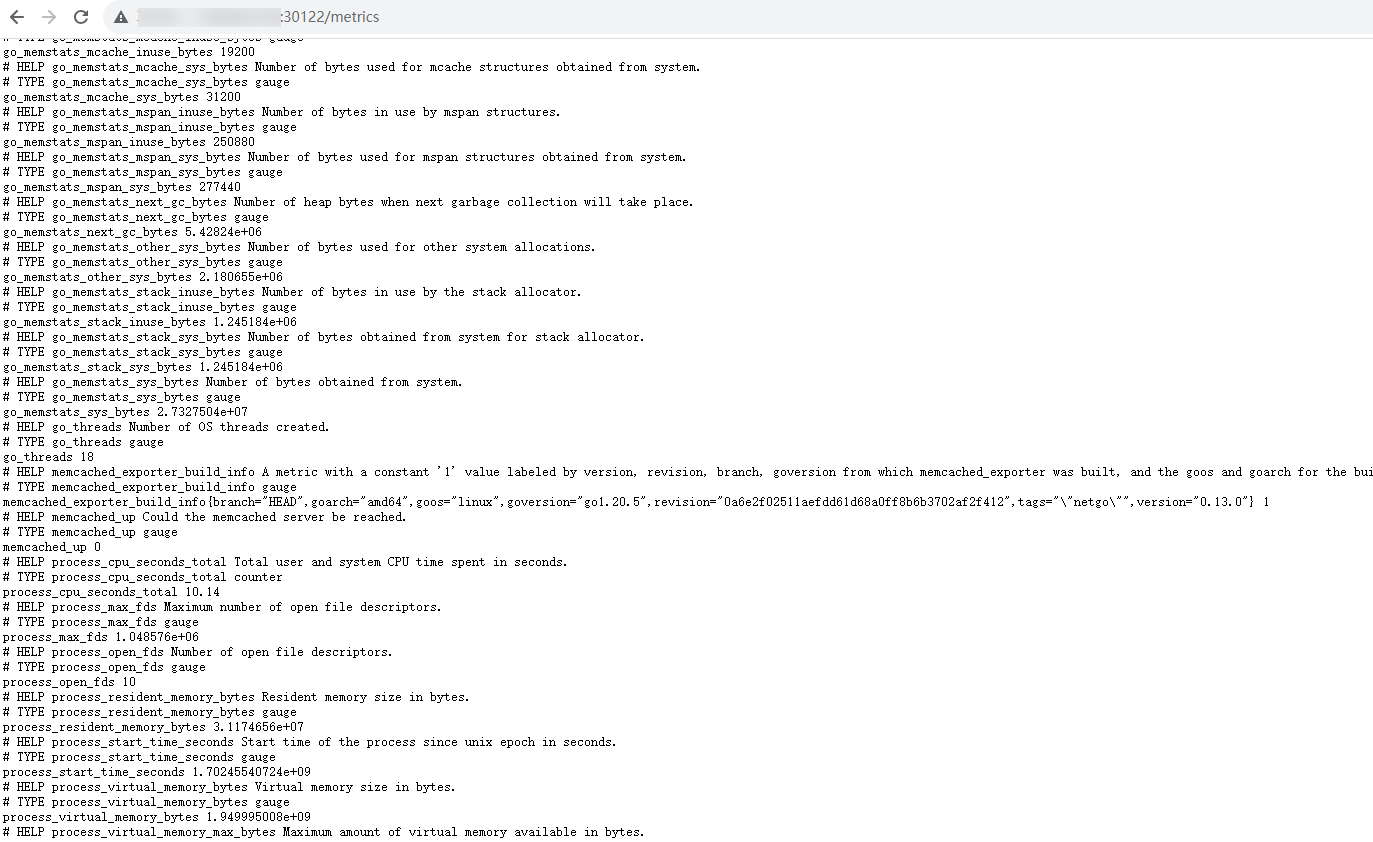

- Run the following commands to check whether Memcached Exporter is successfully deployed. If metric data is returned, it is successfully deployed. Perform verification using one of the following methods:
- Log in to a cluster node and run either of the following commands:
curl http://{Cluster IP address}:9150/metricscurl http://{Private IP address of any node in the cluster}:30122/metrics - Access http://{Public IP address of any node in the cluster}:30122/metrics. Figure 1 Access address
