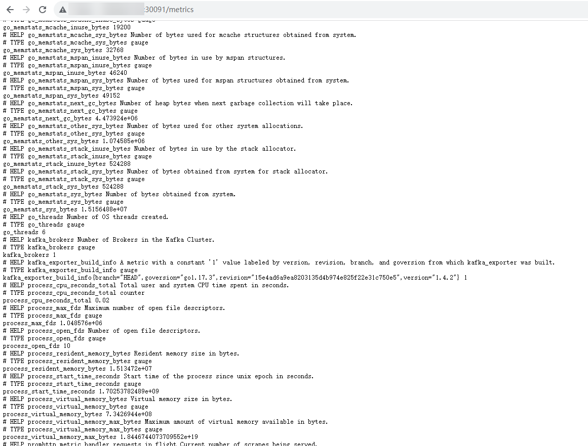

- Run the following commands to check whether Kafka Exporter is successfully deployed. If metric data is returned, it is successfully deployed. Perform verification using one of the following methods:
- Log in to a cluster node and run either of the following commands:
curl http://{Cluster IP address}:9308/metricscurl http://{Private IP address of any node in the cluster}:30091/metrics - In the instance list, choose More > Remote Login in the Operation column and run the following command:
curl http://localhost:9308/metric
- Access http://{Public IP address of any node in the cluster}:30091/metrics. Figure 1 Access address
