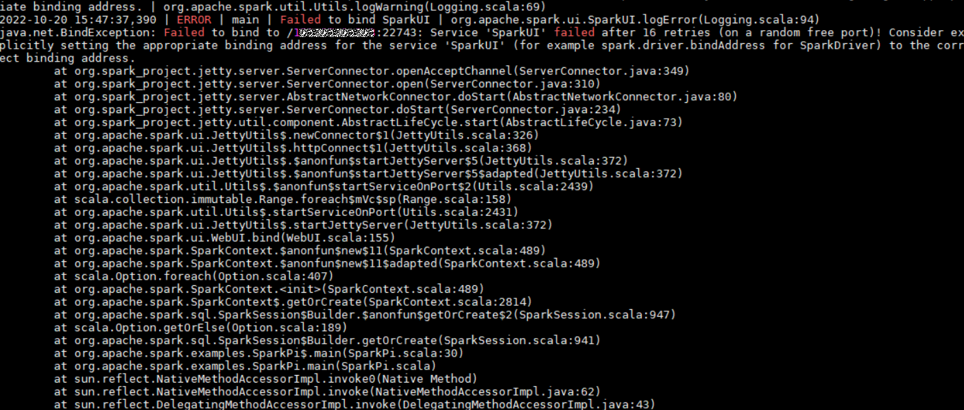

安装集群外客户端或使用集群外客户端时,有时会出现连接Spark任务端口失败的问题。
异常信息:Failed to bind SparkUi
Cannot assign requested address: Service ‘sparkDriver’ failed after 16 retries (on a random free port)! Consider explicitly setting the appropriate binding address for the service ‘sparkDriver’ (for example spark.driver.bindAddress for SparkDriver) to the correct binding address.

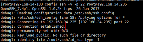

    查看端口是否被占用:
    ssh -v -p port username@ip
    如果输出“Connection established”,则表示连接成功,端口已被占用。
