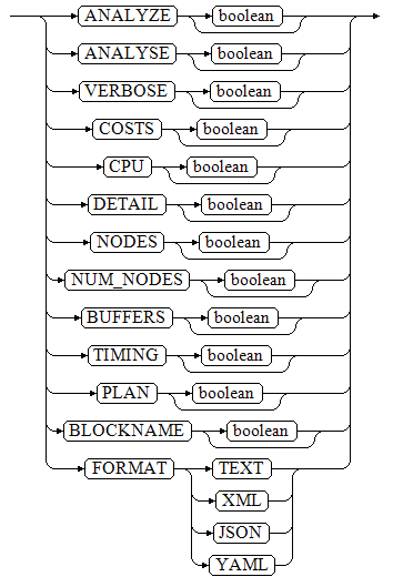

其中选项option子句的语法为。
1 2 3 4 5 6 7 8 9 10 11 12 13
ANALYZE [ boolean ] | ANALYSE [ boolean ] | VERBOSE [ boolean ] | COSTS [ boolean ] | CPU [ boolean ] | DETAIL [ boolean ] | NODES [ boolean ] | NUM_NODES [ boolean ] | BUFFERS [ boolean ] | TIMING [ boolean ] | PLAN [ boolean ] | BLOCKNAME [ boolean ] | FORMAT { TEXT | XML | JSON | YAML }
