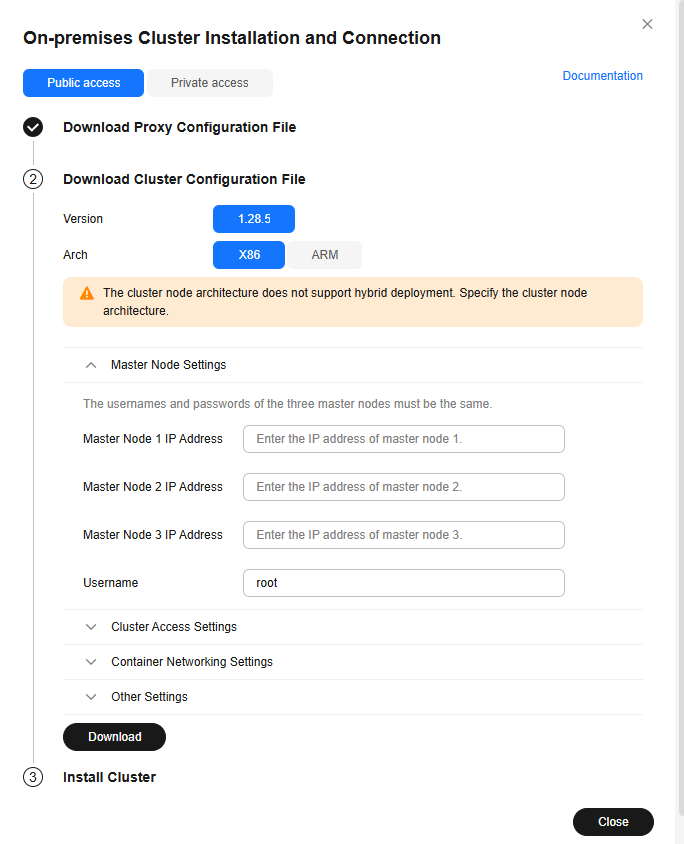

- Set the parameters required for cluster installation and download the cluster configuration file cluster-{Cluster name}.yaml.
If the cluster version is 1.28.5 or later, set the cluster architecture to x86 or Arm.
Figure 1 On-premises cluster installation and connection - Use the remote file transfer tool to upload the agent-{Cluster name}.yaml and cluster-{Cluster name}.yaml files to the /root/ directory on the executor as root.
