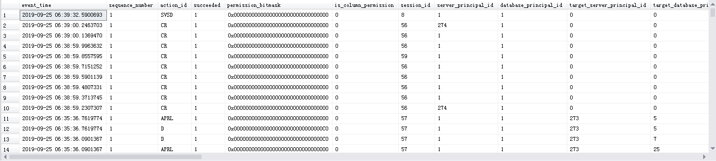

- To read audit logs, you can obtain the audit log file name from the console and then run the following statement:
select * from msdb.dbo.rds_fn_get_audit_file('D:\ServerAudit\audit\RDSAudit_test.sqlaudit', default, default)
If you have already downloaded the audit log file to a local directory, log in to your local SQL Server database and then run the following statement (the local account must have the CONTROL SERVER permission):
select * from sys.fn_get_audit_file('\\path\RDSAudit_test.sqlaudit', default, default)

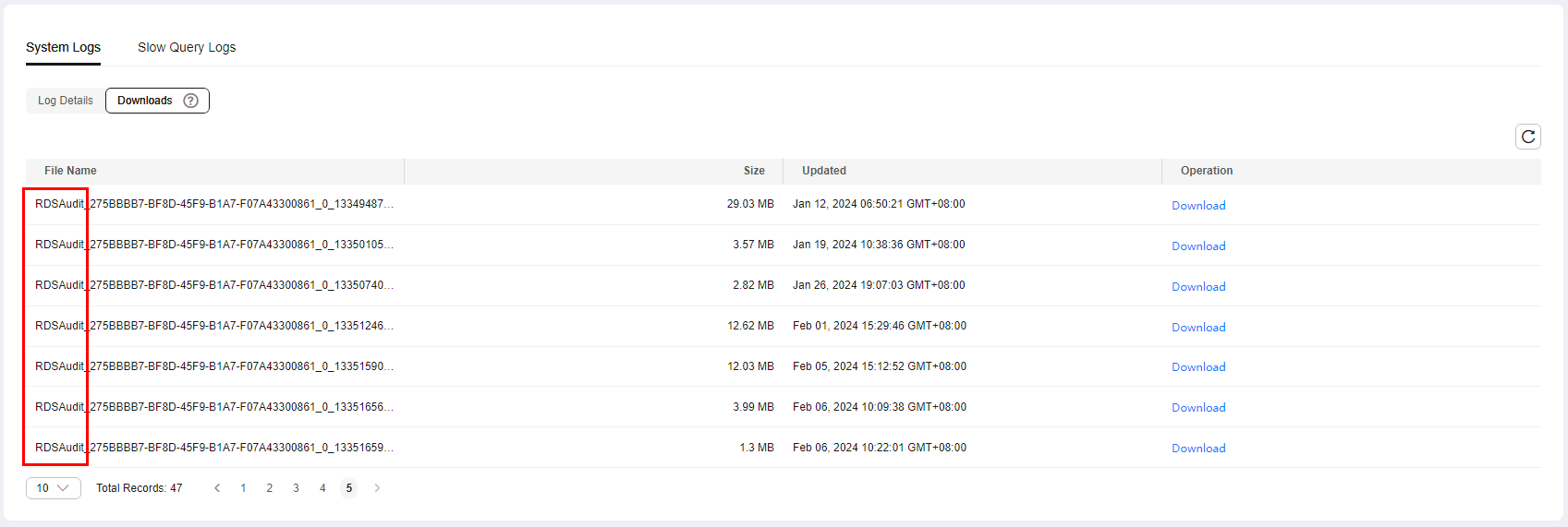

- On the displayed page, select a time range in the upper right corner, select SQL audit logs to be downloaded in the list, and click Download above the list to download SQL audit logs in batches.
Alternatively, select an audit log and click Download in the Operation column to download an individual SQL audit log.
