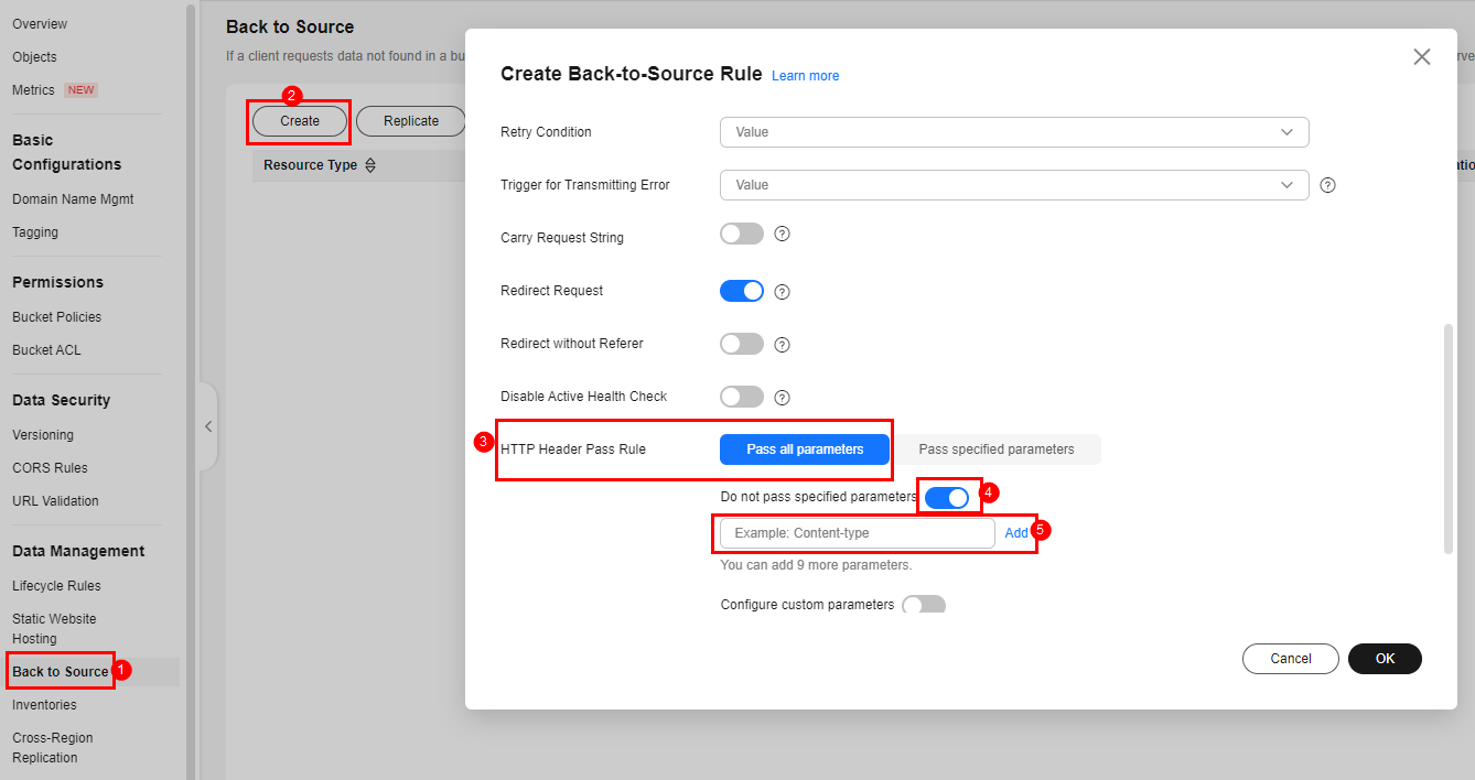

  • Transfer-Encoding: chunked cannot be used for the origin server to transmit data, or the origin pull will fail. The response to the request for downloading an object from the origin server must contain the Content-Length header to specify the size of the source object.
    To achieve this, in the Create/Edit Back-to-Source Rule window, choose Pass all parameters for HTTP Header Pass Rule, enable Do not pass specified parameters, and add Accept-Encoding.

Figure 3 Configuration method
