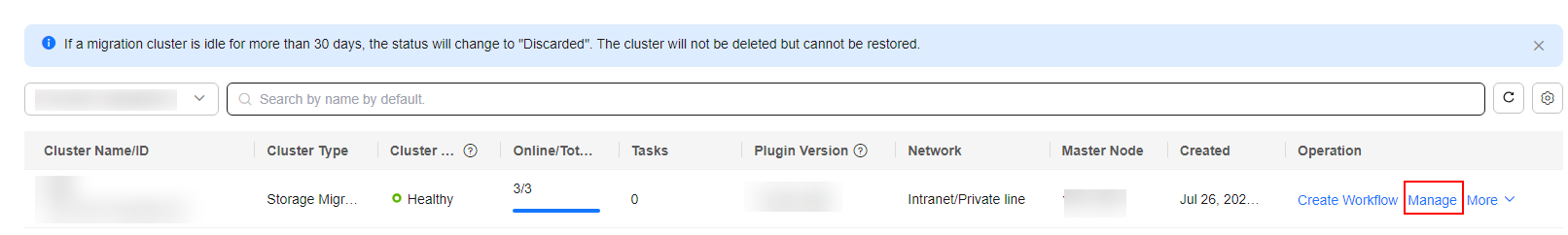

- Sign in to the MgC console. In the navigation pane, under Project, select an application migration project from the drop-down list.
- In the navigation pane on the left, choose Other > Migration Clusters.
- In the cluster list, locate a migration cluster and click Manage in the Operation column.
- In the Traffic Limiting area, click Add to add a rule.
- Configure the start time, end time, and bandwidth limit.
For example, if you set Start Time to 08:00, End Time to 12:00, and Maximum Bandwidth to 20 MB/s, the maximum migration speed is limited to 20 MB/s when the migration task is running in the period from 08:00 to 12:00. The migration speed is not limited beyond this period.
- The time is the local standard time of the region you are migrating to.
- A maximum of five rules can be added.
- Click Confirm.

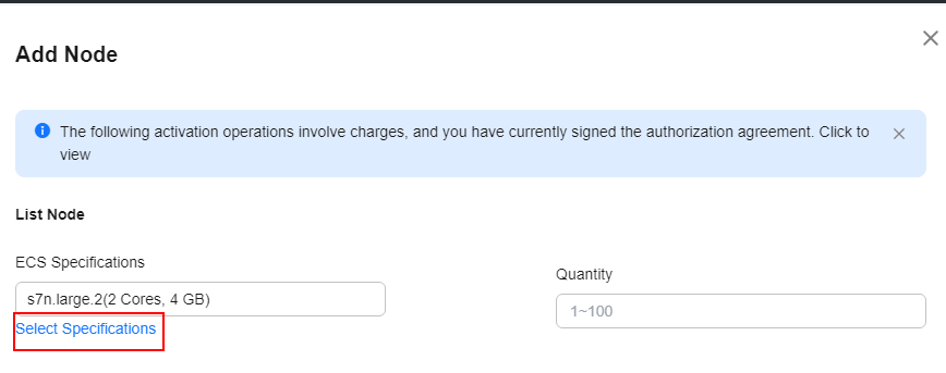

- In the cluster list, click Manage in the Operation column.
- In the node information area, choose Add > Migration Node.
- Select the node specifications and enter the number of nodes to be added. The number of nodes in the cluster must meet the following requirements:
- Number of migration nodes + Number of list nodes + 1 ≤ 100
- Number of migration nodes + Number of list nodes + 1 ≤ Number of unused IP addresses in the subnet
- Click Confirm. After the nodes are added, MgC starts to install the migration plug-in on these nodes, and you can view the added nodes in the node list.
