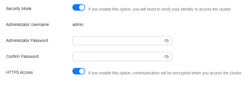

Switching from the Non-Security Mode to Security Mode
You can change a non-security mode cluster to a security-mode cluster that uses HTTP or HTTPS. After a cluster's security mode is enabled, user authentication is required for accessing the cluster.
  1. Log in to the CSS management console.
  2. In the navigation pane on the left, choose Clusters > OpenSearch.
  3. In the cluster list, find the target cluster, and choose More > Modify Configuration in the Operation column. The Modify Configuration page is displayed.
  4. Choose the Change Security Mode tab.
  5. Enable the security mode. Enter and confirm the administrator password of the cluster.
    Figure 1 Switching from the non-security mode to security mode
  6. Enable or disable HTTPS Access.
    • If you enable HTTPS Access, HTTPS is used to encrypt cluster communication, and public network access can be enabled for the cluster.
    • If you disable HTTPS Access, HTTP is used, and public network access is disallowed for the cluster.
  7. Click Submit, and confirm the information. The cluster list is displayed.
    The Task Status of the cluster is Changing security mode. When the cluster status changes to Available, the security mode has been successfully changed.

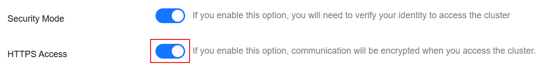

Switching between HTTP and HTTPS in Security Mode
You can change the protocol of a security cluster.
  • If a public IP address has been assigned to a security-mode cluster, unassign it before changing from HTTPS to HTTP.
  • HTTPS can only be disabled for OpenSearch 1.3.6, 2.19.0, and 3.4.0 clusters for which the security mode is enabled. For other versions, HTTPS access cannot be disabled.
  5. Enable or disable HTTPS Access.
    Figure 3 Configuring the protocol
      HTTPS is used to encrypt cluster communication, and you can enable public network access for the cluster.
    • If you disable HTTPS Access, an alarm message is displayed. Click OK to disable the protocol.
      Cluster communication is no longer encrypted and public network access cannot be enabled.
  6. Click Submit, and confirm the information. The cluster list is displayed.
