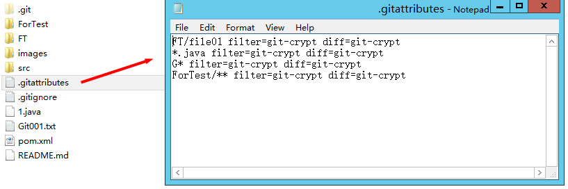

  3. Run the following command to configure the encryption range for the repository:
    1. Create a file named .gitattributes in the root directory of the repository.
      • If the system prompts you to enter the file name when you create the .gitattributes file, you can enter .gitattributes. to create the file. If you run the Linux command to create the file, this problem does not occur.
      • Do not save the .gitattributes file as a .txt file. Otherwise, the configuration does not take effect.
    2. Open the .gitattributes file and run the following command to set the encryption range.
      <file_name_or_file_range>: filter=git-crypt diff=git-crypt
      Four examples are as follows:
      FT/file01.txt filter=git-crypt diff=git-crypt  # Encrypt a specified file. In this example, the file01.txt file in the FT folder is encrypted.
      *.java filter=git-crypt diff=git-crypt  # The .java file is encrypted.
      G* filter=git-crypt diff=git-crypt   # Files whose names start with G are encrypted.
      ForTest/** filter=git-crypt diff=git-crypt   # Files in the ForTest folder are encrypted.

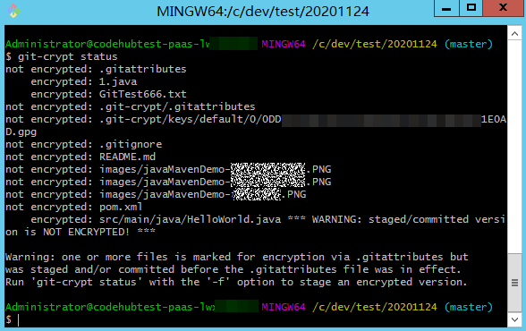

  4. Encrypt the file.
    git-crypt status encrypts only the files to be committed this time. It does not encrypt the historical files that are not modified this time. Git displays a message for the unencrypted files involved in this setting (see Warning in the following figure). If you want to encrypt all files of a specified type in the repository, run the git-crypt status -f command. The -f (force execution) option is risky. Exercise caution when using this option.
    Open Git Bash in the root directory of the repository and run the following command to encrypt the file. The encryption status of the file is displayed.
    git-crypt status
    After the encryption, you can still open and edit the encrypted files in plaintext in your local repository because your local repository has a key.
    You can run the add, commit, and push commands to push the repository to CodeArts Repo. In this case, the encrypted files are pushed together.
    Encrypted files are stored in CodeArts Repo as encrypted binary files and cannot be viewed directly. If you do not have a key, you cannot decrypt these files even if you download them to the local computer.

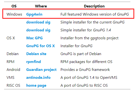

  3. Download the GPG of the latest version. When you are prompted to donate the open-source software, select 0 to skip the donation process.
    Double-click to start the installation. Click Next to complete the installation.

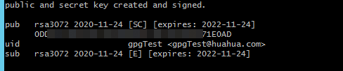

  4. Generate a key pair in GPG mode.
    1. Open Git Bash and run the following command:
      GPG --gen-key
    2. Enter the name and email address as prompted.

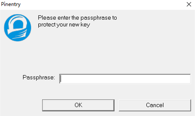

    3. Enter o as prompted and press Enter. The dialog boxes for entering and confirming the password are displayed.
      The password can be empty. For information security, you are advised to set a new password.
    4. If the following information is displayed, the GPG key pair is generated successfully.

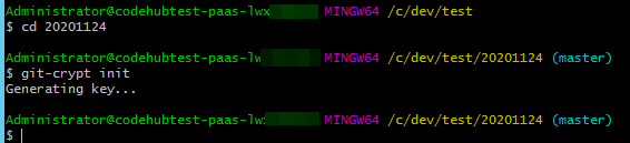

    1. Open Git bash in the root directory of the repository and run the following command to initialize the repository:
      git-crypt init

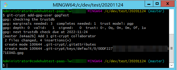

    2. Run the following command to add a copy of the key to your repository. The copy has been encrypted using your public GPG key.

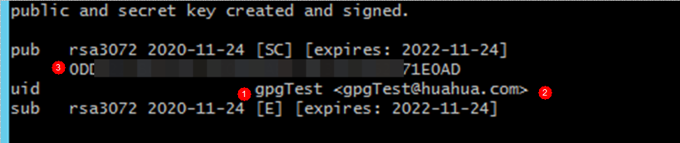

      git-crypt add-GPG-user USER_ID
      USER_ID can be the name, email address, or fingerprint that uniquely identifies the key, as shown in 1, 2, and 3 in the following figure in sequence.
      After the command is executed, a message is displayed, indicating that the .git-crypt folder and two files in it are created.

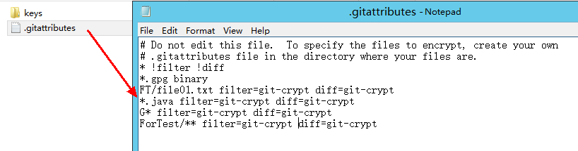

    3. Copy the .gitattributes file to the root directory of the repository.

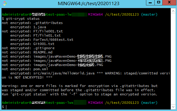

  7. Encrypt the file.
    git-crypt status encrypts only the files to be committed this time. It does not encrypt the historical files that are not modified this time. Git displays a message for the unencrypted files involved in this setting (see Warning in the following figure). If you want to encrypt all files of a specified type in the repository, run the git-crypt status -f command. The -f (force execution) option is risky and may cause inconvenience. Exercise caution when using this option.
    git-crypt status
    Encrypted files are stored in CodeArts Repo as encrypted binary files and cannot be viewed directly. If you do not have a key, you cannot decrypt it even if you download it to the local computer.

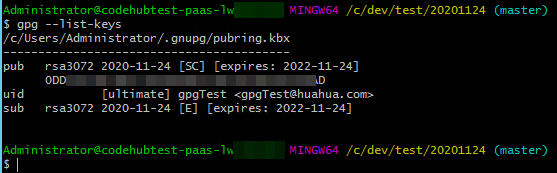

    1. Lists the currently visible keys. You can view the name, email address, and fingerprint of each key.
      GPG --list-keys

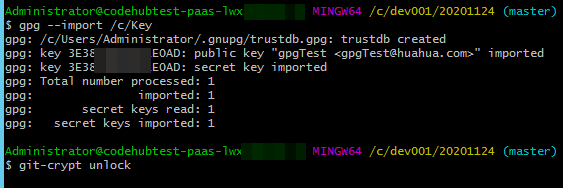

    4. Go to the repository, open Git Bash, and run the import command to import the key. You will be prompted to enter the key password during the import.
      GPG --import  /c/key
    5. Run the unlock command to decrypt the file.
      git-crypt unlock
      During the decryption, a dialog box is displayed, prompting you to enter the password of the key. If no command output is displayed after you enter the correct password, the decryption is successful.
